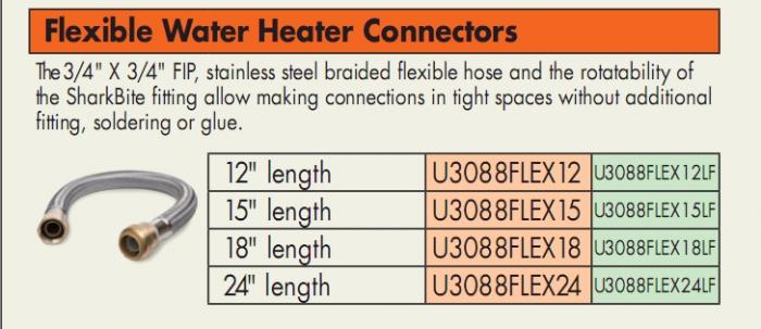

I use Bradford water heaters with the nipples already in the top of the tank. Mark, have you seen these?
[/QUOTE]

flex
My experience with stainless steel flex hoses is that they will kink before you can make a tight turn with them. The corrugated copper is MUCH better.
the blackones from Brass Craft are much better then those SS ones..
I think those you have posted with the shark bites cost about 18 bucks each ...
my black ones are about 8
