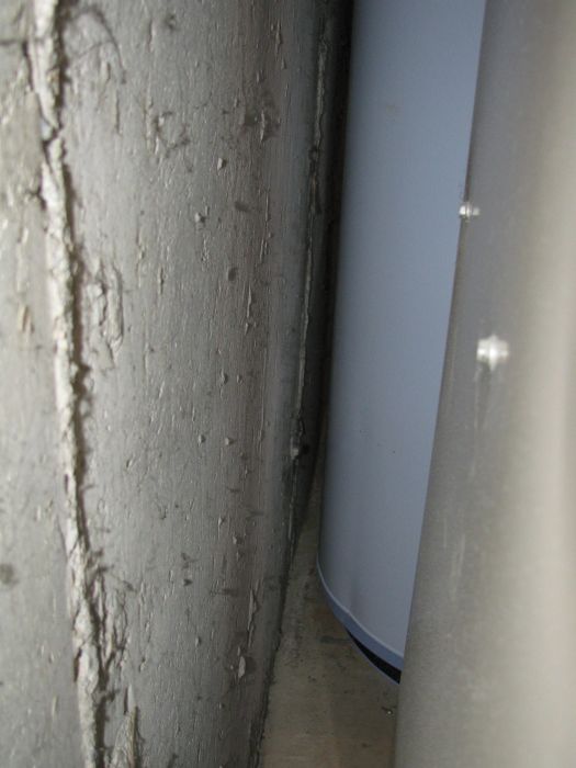

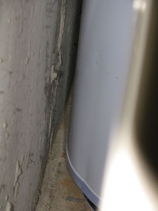

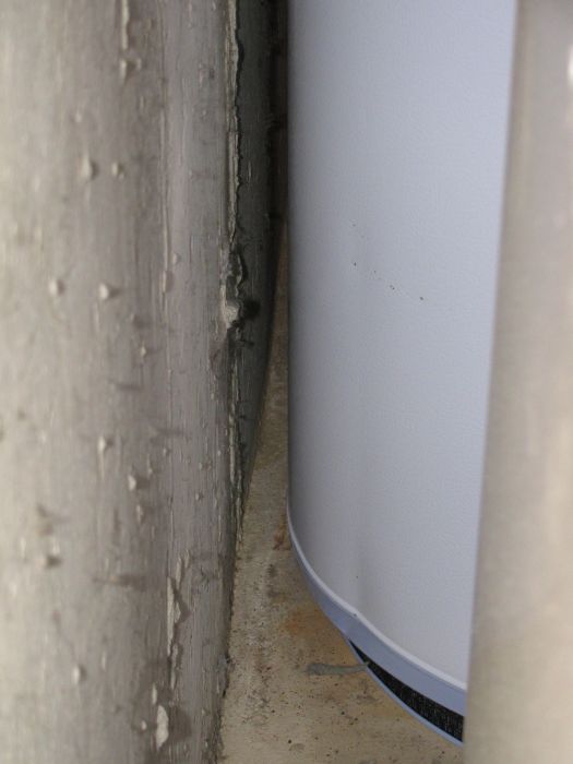

This whole experience has been a nightmare.....look at these pics...do I have a gripe with Sears? Should I demand that they replace it? If so this would be my third water heater from them this month. There is also a crease a bit higher up....at the bottom of the blue band it is bent down slightly too...wtf
I am so depressed on how my life has been a living hell just because I wanted to replace a water heater...
Cosmetic or more than that? Should I complain to Sears and see if I can get some $$ knocked off? Or demand a new tank which will put me out of work for another day and probably get me fired
I have another installer coming tomorrow to install the 4 inch flue pipe and take out the 3 inch....I demanded to Sears that I did not want the original installer back ever again...should I point this out to the new plumber and think he will give an honest assessment?
I am so down

Hmm, it probably looks worse in the closeup pics than it really is. If this is a glass lined tank, then it might be worth it to get it replaced up front.
If you are having this much trouble and stress over this install, then it might be best to just leave it as is. You probably got a good warranty with sears, and so this water heater should be protected for a while. To me, that just looks like a small dent, and so it shouldn't have done anything to the heater.
If it were me, I might have taken that heater back to the supplier because the dent looks like it travels up the tank a bout a third of the way. But without seeing it in person, I can't say for sure. Unfortunately a lot of these companies that do water heater installs expect their installers to just slam in a heater in half an hour, which is not enough time to do a quality job. I inspect everything and leave the place cleaner than I found it!

The dent is PURELY cosmetic. I wouldn't worry about it what-so-ever. If I had to take back every tank I got that had a little dent in it I'd be taking back LOTS!
The shell of the tank is sheet metal and they dent quite easily *shrugs*

I can understand the frustration. When I buy something new I expect it to be delivered in new/resaleable condition. Scratched and dented is not acceptable to me. The question I have is was there any indication of this damage in the packaging? Or was it a problem with handling by whoever placed the tank there? If the delivery was done without the deliverer inspecting the tank then they have essentially accepted responsibility for it.
On the other hand, other than appearances (cosmetic) I doubt this indicates a functional problem. The outer layer is just to contain/house the insulation. It is not part of the pressure vessel and I would not expect the damage shown to have damaged the pressure vessel or even a glass lining. It doesn't seem to indicate a drop or puncture that might have resulted in a jarring of the tank pressure vessel itself.

I wouldn't worry about that dent. Mine has bigger dents than that due to its age. They can take a lot. To me, I wouldn't replace it or give the plumber the hard time. Those things are very difficult to handle. It is nothing.

It's hard to get one dent/ding free ask any plumber. At some point you got to know when to call it good, for your own sanity. ;)
A water heater weights several hundred pounds, and is transported across country and then hand trucked into your basement.
Sometimes by one installer, sometimes by two.
I've known plumbers that lost a week of work and more trying to catch a tank that started falling while moving it with a hand truck.
These are unwieldy beasts.
What you see, is a crease in the wrapper the heater comes in.
The real tank is behind the steel coat, and then a thick layer of insulation, and then you finally get to the seed.
The inner tank that holds the water is safely tucked inside.
You can pound and dent the outer wrapper all you want, and it's not going to change anything.

The last heater I installed had 2" of insulation between the outer cover and the tank.
Judging by the the crease on your outer liner, there is no way your glass lined tank would have been harmed.

The tank is no where near those dents...you are worrying about nothing...the only thing on the other side of the bottom dent is air...there isn't even insulation there near the bottom dent it is to low...
