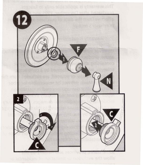

My Moen shower faucet was leaking and I followed the instructions here and easily repaired it. At first, I was confused by the black plastic removal tool that came with my genuine replacement cylinder. Since the instructions didn't describe the part, I thought it was part of the cylinder and, until I realized it's purpose and used it to turn the old cylinder a bit (I guess it just loosens things up a bit because there are no threaded parts.) I was unable to remove the old cylinder. But once I turned the cylinder a bit, I screwed the faucet handle back on and easily pulled the cylinder out.

I was showing my wife the old cylinder and how it worked. While doing so, I noticed some white material in the water inlet area and after prying and tugging a bit, I extracted a piece of plastic. I knew immediately what it was!
About two years ago and after the vibration had plagued us for about a year, we replaced our water heater. When the plumber disassembled the hot water outlet pipe, he discovered several pieces of white plastic jambed in the copper pipe. He determined that the white plastic cold water inlet tube (or hot water outlet tube--I forget which) had disintegrated and gotten forced out into the hot water line. I can now see that pieces of this tube must been forced much further from the source and perhaps that was causing the vibration somehow.
