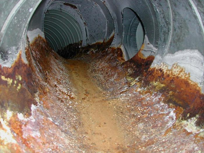

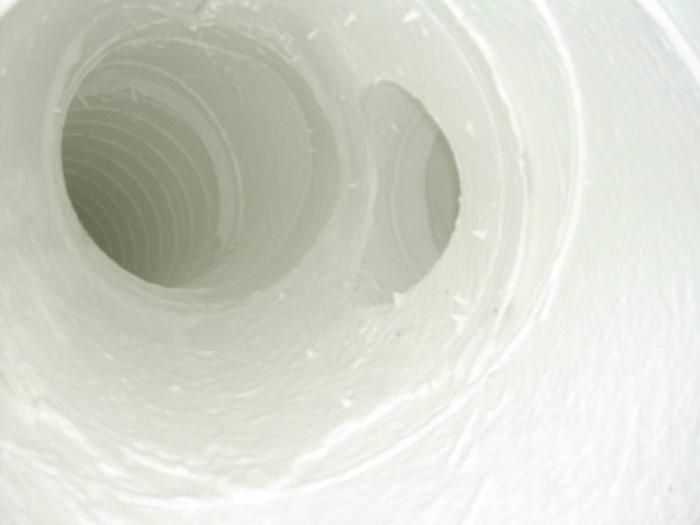

    If anyone has problems with underground air duct systems that have deteriorated, filled with water, or simply rusted out, I have a system that can repair them successfully. We spray a latex-based liner material into the ductwork with a live video and most homes can be completed in one day.
    The liner is sprayed directly into the ductwork through the registers and plenum and the heating & air system can be run immediately after the spraying process. Its a great alternative to more expensive solutions such as remodeling or demolition of the slab.
    My website is www.Enviroductseal.com and I would welcome any questions that anyone may have. We have successfully been restoring galvanized, transite, AK and even fiberglass ductwork encased in the foundation.
