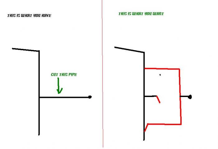

    Im new here. I stumbled onto this site when I was looking for solutions to my new project. I want to make sure I do it right. Unfortunately I don't have anywhere to upload images to the web. I will try to describe the situation best as possible and maybe someone will vonunteer to help me via email. I do have pics.
    In my basement I am installing some cabinets and a sink. Basically a small bar on a 9 foot wide wall. On the other side of the wall is the bathroom. For the supply I am pretty sure I can just tap into the existing pex pipe. For the drainage I want to make sure it is vented properly and up to code.
    There is one vent pipe coming up from the floor that goes right to the roof as far as i know. It is right next to the toilet. So I figure that is the vent for the toilet. The sink drain runs horizontal, then tees down into the floor (to the main drain I guess) and virtical, then makes a 90 and tees into the vent pipe.
    I need to basically tap into the drain and the vent and do it properly. If someone is willing to help me via email they can contact me at kevinhedrei@hotmail.com. I will try to find a way to get my pics posted.
    Thank you in advance.
    Kevin

    The red lines represent the new piping attached to the old piping represented in black.

    Thank you very much. That makes sense to me. I assume since you didn't mention anything that the 2.5" abs is sufficient for venting the extra water load (not that everything will be draining at the same time anyway). I just want to make sure it is up to code.

    Your vent is either 1 1/2" or 2" (i can't really tell from the photo), but will be sufficient and will meet Ontario plumbing codes (no such thing as 2.5" abs) We measure the inside diameter of the pipe
    Your drain for the bar sink will be 1 1/2" and your wash basin is probably 1 1/2" but it could also be 1 1/4" ( can't tell by the photo)

    2in. (you measure pipe by the i.d. is fine for what you are doing.
    If you plan to use KROWS' lay out remember that your vents have to be 42in above the floor before you can go horizontal, luck.

    Sorry, yeah, they are 1.5" abs pipes.
    Shacko, in my picture in the current set up the builder brought the banthroom vanity drain horizontal then when it hit the vent it went up and then 90'ed to the left at 33". So does that mean that they didn't do it by code? Should I change it? Because if I do Krow's set up I will have to take out more drywall to the left and tap it into the main vent much higher up.
    12,437
    The builder did it right for one sink.
    If you want two sinks, then Krow's way is right.

    So if I do it Krow's way then when I re-run the vent for the existing sink I should run it up over 42" before 90'ing to hit the main vent? Or can I tee it back into the vertical pipe (the one you see in the pic) that leads to the main vent?

    As long as the new vent connection is above the flood-level rim
    In Ontario, code allows you to tee your vent over 40" to centre. Most counter tops are36" from finished floor. In Ontario, you are allowed to 90 to horizontal at any height as long as horizontal vent slopes 1/2" per foot and you tee to the main vent needs to be min. 40" to centre.

    The bar sink can have a higher drain connection than the lavatory, so you could just insert a second tee above the lavatory one and arm over to the sink location. The vent line being below 42" is a theoretical problem but not usually a practical one. IF the drain line becomes obstructed, the water will fill rise in the pipe until it overflows the lower sink, which should be the lavatory at 31" above the floor. It could NEVER get high enough to fill the bar sink or bypass through the vent into the main vent. In any case, you would know very quickly that you have a problem.
