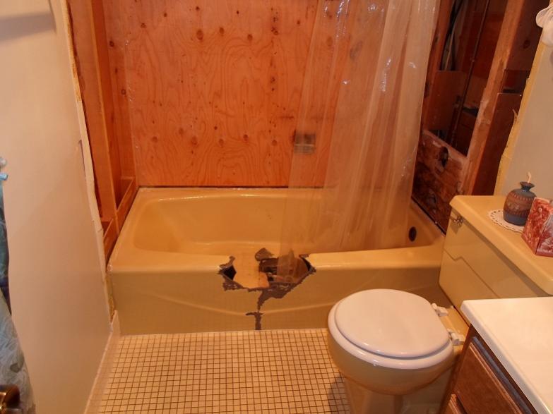

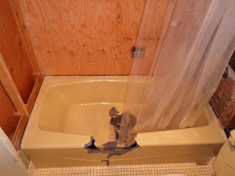

    This thread has been very helpful. I am in the process of removing a "harvest gold?" cast tub and was thinking of putting in a Kohler Villager since it looks exactly the same, except being white. Does it matter that the diagonal of the tub is longer than the room, or does it not since the tub is open underneath? Any thoughts on how I might remove mine? I was thinking of taking the panel off of an adjacent closet, tipping the tub on the side and sliding it out through the closet ;*) If I could spin it on the it's side in the bath I would. The skirt has a copper/fin heat pipe running through it!

    That gold tub is definitely a Kohler Villager -- can't miss that Nike swoosh on the apron...

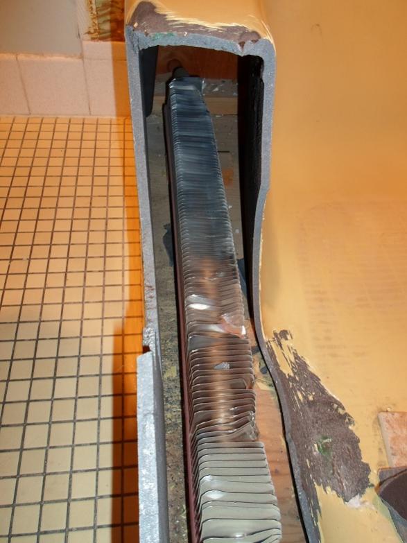

    The complicating factor here is that finned copper radiator pipe buried inside the apron--a clever way of hiding the radiator in the room.
    I'd say that the first thing you need to do is remove the finned copper piping. Are there removable fittings where the pipes meet the floor/walls? Or did they solder it in?
    If you can't get at those fittings (or if they don't exist), then I'd say you have no option other than to continue breaking the tub into pieces. Then (at least temporarily) remove the radiator pipes before you put a new tub in. The toilet is going to have to come out, and it would probably make it easier (more room to maneuver) if the vanity came out too.
    - John

    Based on how tightly-fitted those radiator fins look inside the tub apron, I don't think you'd stand much chance getting a new tub over top of it unless you dropped the tub straight down on it. And I can't imagine doing that with a cast iron tub.
    Perhaps you could install the copper unions on the radiator pipes below floor level yourself??
    Regardless, I think you need to bust up the old tub first.
    Then post a picture of the finned radiator piping so we can see what you're up against.
    Here is the radiator.

    I don't think you can get very much heat out of that setup. Copper fin heat is based on convection. You won't get much of that from the section of copper fin. It would be like closing the damper on the baseboard.

    The copper fin doesn't come in contact with the tub. It's not like a cast iron radiator were the water is running through it. There is no air circulation under the tub to produce heat. That set up wouldn't have even heated the room.

    Humm, a light bulb's filament doesn't touch the glass, but the glass gets plenty hot. Heat is heat...while there isn't much air in that cavity, what's there will circulate. Yes, my example isn't as extreme as the hot water in there, but even a convector that is closed up will get hot - it just won't warm the room as effectively.

    You can't touch a light bulb that's been on but you can handle copper fin that has 160-degree water running through it.

    Ok, I'm going to take out the panel in the closet on the left hand side of the picture. The 2x3 is going to be cut and then we will drag/walk the tub out through the closet. From there we will use either a dolly or slide it on the skirt.
    Ledger: this tub has no ledger and no shims and the feet rest on plywood, been here for 36 years! If I wanted a ledger would the cast tub need to be set in place and then marks put on the wall? Or would I measure based on the specs and put on a level board and set the tub in once?
