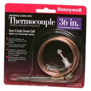

    hi guy's this is the thermocoupler i use one year I had to replace it two times is there something I'm missing here. its on a boiler that heat's the house.

    Gas valve solenoid coil resistance too low?
    Two defective TCs?

    Put in a brand new thermocouple and do a drop out test on it to see how strong of signal it's putting out.
    If it puts out a weak signal try another new thermocouple (some are just bad from the factory). If BOTH seem to be putting out weak signals it's quite possible your gas valve is starting to fail.

    Ignore this procedure, or atleast the valid times it gives for how long the drop out should take. Unless you have a Bosch water heater but I reread the entire post and don't see where you said you had one.
    In BC the thermocouple is allowed to keep the gas valve's pilot light on for up to 90 seconds after you blow the pilot out.
    If I do a drop out test on a thermocouple and it can't keep the gas valve on longer then about 30 seconds I change it out. I like to see 50 seconds+ though.

    A thermocouple that gets too hot will fail, or more precisely will stop generating power to maintain the coil in an open position. IF the main burner flame is so large it is encompassing the thermocouple, or if the pilot light is not on the tip of the thermocouple, its operation will be erratic. Overheating and age are about the only two causes of thermocouple failure, and if yours are going bad that quickly age is probably not the cause.

    i think its more about the flame i looked at the old one and its burned on the side the the top
