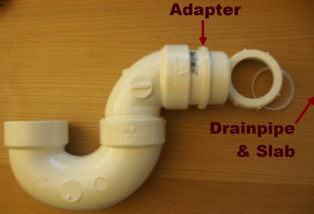

Hmmm. I just had another idea at Home Depot.
Can I use a compression-nut fitting (like the ones used to join the overflow and tailpipe to the drain's Tee-fitting) to connect the P-trap to the drainpipe projecting from the slab in lieu of the mission coupling? Or is that [a bad idea | likely to be a code violation] ?
What I have in mind is to firmly attach the adapter to the drainpipe, then glue the trap together and glue it to the adapter. The general idea being that if I ever need to redo it someday, I can cut off the trap, then nondestructively unscrew the nut holding it on to the drainpipe.
Assuming it's not bad or illegal, would it likely be a better or worse solution than the mission coupling?

^^^ Oops. Two new discoveries...
1. Contrary to what I believed an hour ago, the mission coupling did NOT slip and loosen during installation of the tub drain. It was, in fact, fully covering the drainpipe right up to the rubber separator in the middle.
2. The drainpipe coming from the slab won't actually FIT into the hole in the adapter's nut.
#2 was a disappointment, but #1 worries me. A lot. I apparently DID have both the drain's Tee and the drainpipe fully-inserted into the mission coupling, and I had both screws seemingly tight. Yet, it still leaked. It didn't gush or anything, but one week of daily baths, and the ceiling below would absolutely be damaged. Until I figure out why it was leaking, and how to reinstall it so it doesn't, I'm kind of at an impasse :-(
