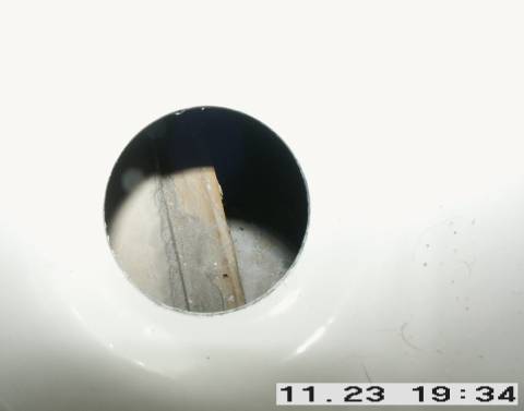

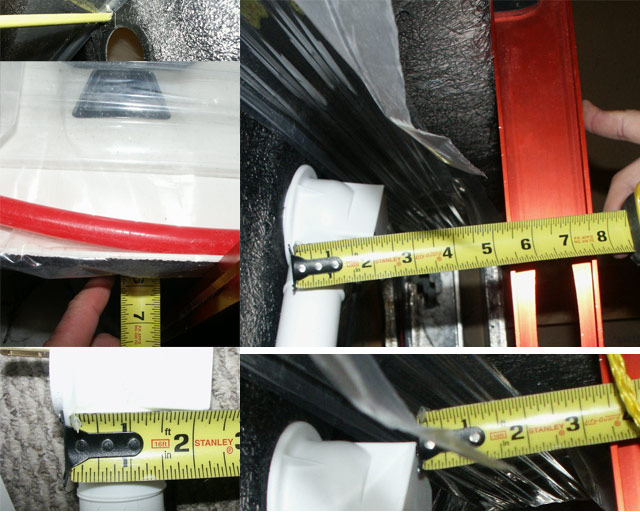

    The biggest problem I'm seeing right now is the apparent fact that the old bathtub's P-trap is about 3 inches too far back. If you look at picture 1, you can see how I calculated it:
    tub edge to back of overflow drain: ~5.75"
    overflow drain, front to back: 2.25"
    back of overflow drain to tub edge: 3.5"
    subtracting .75" (half the 1.5" pipe") from 5.75" suggests that the new overflow drain's pipe is going to be approximately 5" back from the stud. The old pipe was apparently ~2.25" back from the stud.

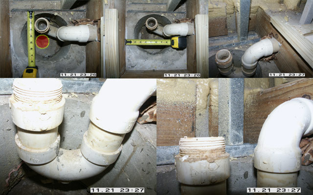

    Now, for the fun. As far as I can tell, I've removed everything from the old drain that can be nondestructively removed. It looks like everything from this point is going to involve cutting and gluing PVC.
    The fun part, of course, is the fact that the two vertical pipe sections are both inside the ~8" diameter hole formed in the second floor's slab (the bottom of the hole is the top of the living room's drywall), so getting a saw in there won't be fun, and would probably require buying some expensive new tool(s). HOWEVER, replacing the entire P-trap won't be much more fun, because it only has about an inch before it disappears into the slab.
    I should mention at this point that the bathroom is actually a slab cast on top of another slab. The builder formed the second floor's slab, then poured a second slab (delineated by the wood around the drain pit, and elsewhere around the bathroom's perimeter) with the drain pipes embedded inside. In a pinch, I could probably pry away the board the drainpipe passes through to get another half inch of pipe to work with, but for obvious reasons I'm nervous about cutting the pipe, because if I cut too much, the only way more pipe can be exposed is by breaking away concrete (at god knows what cost). The new 1x2 boards you see at the very top are coming off... I only needed THEM to dam off the area around the self-leveling concrete I poured yesterday.
    So... any suggestions for which pipe to cut tomorrow after I've confirmed that the trap needs to be shifted 2-3 inches further from the wall? Is there any easy way to cut a "pipe in a pit"? Or is my only real option to cut away the entire trap, preserving as much of the pipe sticking out of the slab as possible? What's the absolute minimum length I can have before I'll have to pry away the old board used to form the second slab to expose enough for a proper glued joint?

    If it were me, I would cut the pipe just above the u bend in the trap leaving as much pipe as possible coming down from the 90 sticking out of the wall. I would go get a new trap and trap adapter and a 1' piece of PVC (bring the cut out u bend and trap adapter with you). I would also get what's called a "mission coupling". It's a rubber coupling with metal band around it and use that as the coupling between the pipe coming down from the 90 and the u bend. It tightens with 2 hose clamps and will allow you to move the trap left or right without having to worry about being permanent but you'll need to add a piece of pvc to outlet side of the new trap so the coupling has something to grab onto. Before you glue anything together dry fit everything because you may need to trim the pipe coming down from the 90 so the bottom of the trap will fit.

    The way it looks is the tub sits on top of the 2x's above the concrete floor and the pit was formed just for the trap. To get the few more inches you can chip away at the concrete. It is really not that hard. Sometimes a cold chisel will do or with a concrete bit drill holes next to one another then chip away at it.
    As far as the pipe is concern that is a bitch. You can cleanly cut the pipe right at the rim of the elbow to preserve as much pipe out of the floor as possible but here is the new problem. The pipe will be too short to glue on another elbow. The elbow will not reach the same spot in the pit. You cannot glue on a coupling becuase then it will extend to far over the pit to glue on a elbow. Using "street" elbows after the cut pipe might do the trick. Buy a bag of fitting and start playing around to see what might work. 45 degree couplings might work. I haven't looked it up but if 45 degree street elbows are available then that may work better for you.
    The finale way is cut the pipe and use those rubber couplings, (as stated above) with the two stainless steel clamps to extend the pipe after the cut to get the fit you need.

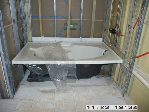

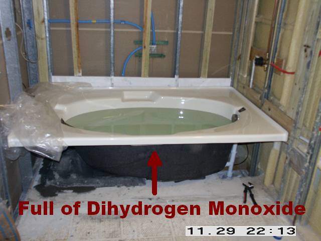

    Epilogue: the new tub is (mostly) installed, and the drain is connected. I still need to shim and screw down the tile flange, but the drain appears to be watertight, and it looks like I put down enough mortar to make it both level and solidly creak-free.
    The self-leveling cement definitely helped, because all I had to ultimately do to make it level was trace an outline of the tub's base with a marker, then glop enough mortar inside the lines to squish down and spread when the tub was placed on top of it, but not quite enough to squeeze out the edges and mess up the nice, level surface the hollow base's perimeter had to sit on.
    One thing I *didn't* install were ledger boards, partly because the tub's (skimpy, generally inadequate) instructions didn't indicate what the normal deflection is supposed to be, but were explicit that the ledger boards must never, ever be loadbearing. If others here think it's important enough, I might try to find some suitable firm, but slightly-squishy foam padding at Lowe's or Home Depot tomorrow night after work, and try retrofitting some ledger boards under the edges. I actually *would* have done it tonight, but I ended up not having time to shop for the squishy foam supports before my friend showed up to help me, and today really *was* the last day he could come for a really, really long time, so it was now or (feeling-like) never.
    Question: should I drill and screw the tile flanges through the shims to the studs with the tub full of water (like it is now), and maximally-depressed? Or should I drain it halfway or all the way before screwing the flanges in?
    Also, what gauge bolts should I use?
    If I have a 1x8 running along the entire side behind the flange, how far OC should the screws be?

    OK, no crisis... I can still get ledge supports under there. The thing is, though, at what deflection level do I want to immobilize the ledge and nailing flange? The point where it's maximally deflected downward (ie, full tub), the point where it's not deflected at all (empty tub), or somewhere in between? And how secure and immobilized to I want the nailing flange to be? Do I want it to be firm, but loose enough to wiggle a tiny bit if forced? Or do I want it to be so secure, the edge where the ledge becomes the nailing flange will crack before the screwed-in flange budges so much as a half-millimeter if the whole thing gets subjected to stress?
    (update)
    "Houston, I think we've, uh, got a problem..."

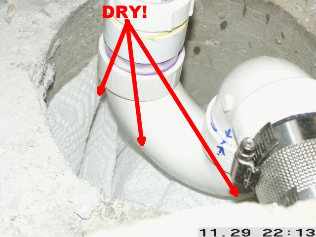

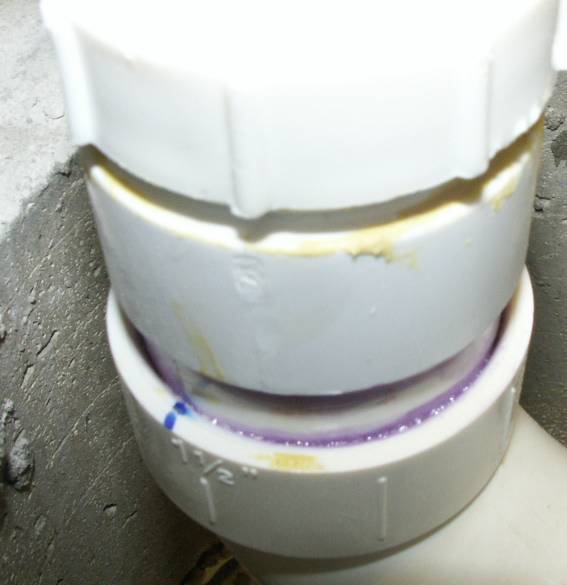

    Last night when I did the initial test draining, I didn't see any evidence of leakage. Tonight, attempting to drain a completely full tub, I found a few, um, "issues"
    1) It looks like the Mission Coupling is leaking.
    2) I saw tiny bubbles in the joint of one of the couplings. I'm assuming they're leakage, and not just the way it dried (see pic).
    3) For a few minutes, I thought I was going to have water coming *up* through the toilet's hole in the floor (flange?). Looking down into it, it kind of looked like high tide at the beach in Key West... water up against the seawall, occasional waves lapping up a little harder, but none coming up and over the "wall". The tub also drained *really* slowly. I think I've just discovered why the master bath's toilet used to clog all the time, and suspect the Champion 4 I bought to replace it isn't quite going to fix the problem. I tried using the ~6' drain cleaner I bought a few months ago, but no debris came out, so I suspect the problem is further "downstream".
    I guess I should probably be thankful for #3, since I suspect the water backing up into the drainpipe and lingering in the coupling is probably why I saw the leakage NOW, as opposed to having it just drip a little tiny bit every day, invisibly nourishing a mold colony down there.
    Sigh. I guess this means I'm going to have to re-do the whole trap, and try to figure out why the glued joint ended up (apparently) being non-watertight. I think I know what happened with the mission coupling, though... right now, it appears to be sitting only halfway on the pipe sticking out of the slab, whereas yesterday I had it basically flush with the slab. I'm not sure how it worked its way loose, though. As far as I can remember, I had everything completely screwed into place before placing the tub and attaching the overflow and drainpipes, so I'm not sure what apparently dislocated it.
    By the way, how tight are the straps on the mission coupling supposed to be? I tightened them using a battery-powered electric drill, with the nut driver, on Torque == 1, and tightened them until it clicked.
