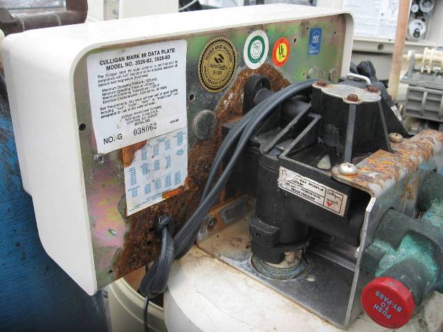

    I'm not sure what I mean "based on time", I only know Kinetico. If we don't do anything based on time, why do I see an electronic clock on a water conditioner? Again, I'm here to learn.
    Again, see my pics posted, any valve isn't going to be a number of feet away and height has nothing to do with salt in moisture or air in an enclosure as a picture is worth a thousand words.

    "You must be confused, there is nothing on a Clack that can corrode. So show us pictures of what you think is a corroded Clack, or post a link to where you saw it. And if you are going to use a softener outside without cover, order the (usually $25) outdoor cover for it.
    I have no Idea what you posted but it's scary to me (covers don't seem to help my situation)...

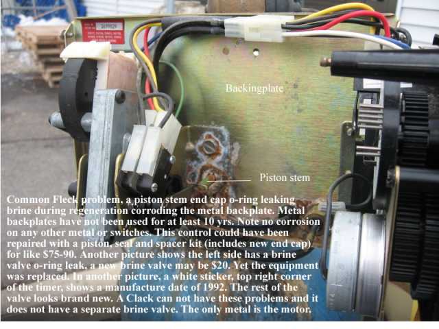

    Quote Originally Posted by fatglide View Post
    I don't see any pictures previous to this post of yours.
    That corrosion in the picture is not due to salt in the salt tank feet away and feet below the control valve, or salty air or humidity etc..
    It is from a leaking piston stem o-ring and/or worn Teflon coating on the piston's stem that leaks a small amount of water only when the piston moves in/out during a regeneration.
    When the piston gets back to the Service position, there is no leak. The valve could work fine like that for many years and I've seen many do just that.
    I have sold many Fleck valves and serviced many of them on Culligan and many other brands of softeners and filters for the last 24 years now and 18 years I sold next to nothing but Fleck valves. And that valve could have been repaired (with a new piston, end cap and a new seals and spacers kit) for less than $200 including say $75 for a service call charge. I've done it many times.
    Here is a picture of the front of that control valve, it's a Culligan. A Kinetico salesman posted the same picture here from various views awhile ago. He has been banned from here and all his posts deleted a month or so ago. He made the same claim you are; he said the corrosion was from salt, salt air etc. and that the Clack would corrode too, which is not possible because the only metal part is the motor housing cover.

    You posted that pic in another thread, I have no idea what I'm looking at or why I see corrosion, all I know is there's plenty of it.
    You get banned for saying salt corrodes here????
    Well anyway, you've convinced me it might not be a big deal even though I see metal, (probably) copper wire and connectors, motor, switches and who knows what else. I'll have to live w/it, perhaps look at a Fleck because it might suit me better??????

    After seeing the picture of your installation I see why you are concerned about corrosion. Unless you modify the housing to provide ventilation--and the ventilation effectively reduces the humidity--I think you would be better off avoiding any electronics and to stick with the Kinetico unit you presently have as suggested by Peter Griffin.
