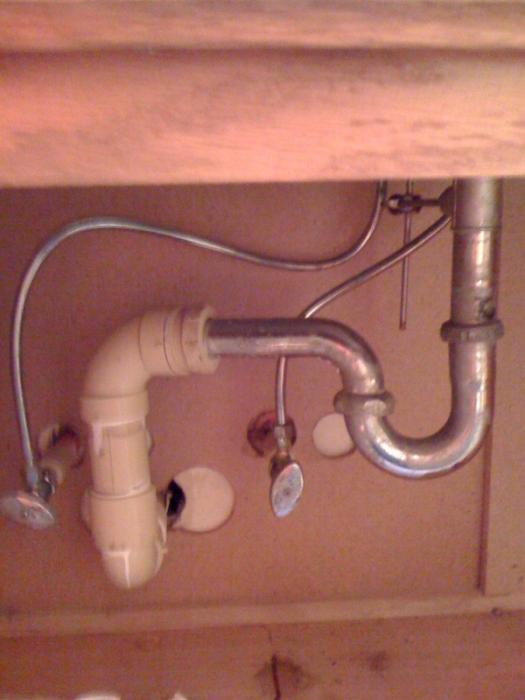

Hi,
I have nearly completed my (first) half-bathroom renovation: new floor, new paint, new toilet, and...new vanity? Almost.
When I removed the old vanity/sink, I cut out the old trap. As advised by members on this forum, I then cut back to the drain pipe coming out of the wall and attached a standard P-trap.
However, when I tried to rough in my vanity cabinet, I discovered that the P-trap hangs too low to clear the lower shelf of the vanity. The wall pipe itself clears the shelf but the downward hang of the P-trap is about 3 inches too low.
Whoever installed the (very old) vanity/sink that I tore out seemed to have encountered the same issue. You can see their solution in the first attached picture -- notice that there is an elbow on the straight wall pipe which turns up, then straight, then right, and then into what looks like a typical P-trap.
If I recreated this configuration it would clear my vanity. But it looks non-standard. Then again, I am very new at all this. Can anyone describe what they did here and whether I could re-create this configuration?

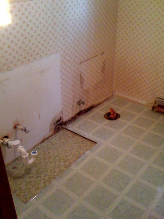

The second photo shows the P-trap I added (before redoing the room -- it looks much nicer now!). But it hangs too low for the vanity.
Appreciate your thoughts!

Is that a backwater/check valve? If so what is it doing there? IF you do not raise the drain in the wall, and that can be difficult depending on how the pipe is arranged in the wall, ALL you can do is cut a slot for the trap to hang into.

In the second photo we can see some kind of an extra fitting/device in the drain line. It appears to have a cap on top which leads us to think it is some kind of a check valve. It should not be there.

It's an s-trap, and could possibly siphon the trap dry.

That little white thingy on the trap arm is an "anti-siphon" port of somekind. I think it's just a built in Studor vent. But beware.....there's some new products that are trying to get approval in my jurisdiciton. I don't know the names but it's a swing check trap arm that "eliminates the sewer gas smell caused by faulty trap primers and dry traps". It eliminates the trap. I've seen two versions, one goes on the tailpiece of a floor drain and acts like a spring check, the other is designed to go on the trap arm of a sink or lav. Any other plumbers seen these?
We said "NO WAY" thank goodness but every few months they try again. For the trap issue, as the guys said earlier, you'll either have to open the wall and raise or lower the waste inlet or you'll have to cut into the shelves to make room.

IT is NOT an "S" trap, and from its appearance it is NOT a Studor or similar vent. It LOOKS like a backwater/check valve, but if so, it is NOT a replacement, or substitution for a trap. It is an ADDITION to the trap, and a poor idea at best. It also has NO function, unless there is also one on the toilet to prevent backflow flooding.

Please define "hangs too low". Your image #2 shows a P trap at the right place.
From there you can Route Your Pipe any way you want, to reach the sink. So you could send a pipe straight up, to a tight elbow, and then over horizontally to another tight elbow under the sink drain tailpiece.
Also, do you know that a P trap can double back on itself? It doesn't have to look like the letter P on its side. It can be a squiggle. You can turn the J part of it back towards the back wall. Try this, if you want to get the riser pipe to be located closer to the wall.
Hope this helps.

AHA! I knew I had seen that trap thingy before,
it's a Genova "NovaVent" Anti-Siphon Trap. Google it and you'll see what "innovative" ideas plumbers are up against.
