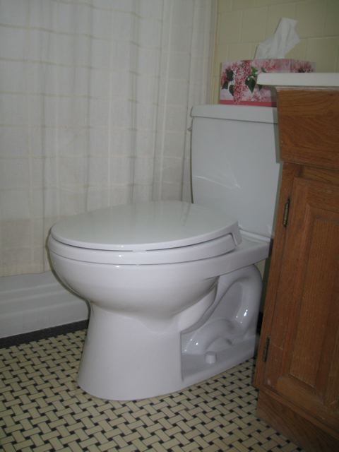

    After much research and agonizing I'm down to deciding between the Caroma Caravelle 305 Dual Flush 1.6/0.8 Gpf and the Toto Eco Drake CST744E with the single 1.28 Gpf. From what I've read, the smaller water spot on the Caravelle may necessitate a second flush (and brush clean) which will defeat it's water saving purposes. I've also heard that the Drake is very efficient and powerful and one flush will handle anything. My main concern is the water savings. I have two kids and a "clean toilet" fanatical wife. Any help with making this decision would be appreciated.

    Finally got The Drake installed. Thanks everyone for the help deciding. The only trouble I ran into was that my old toilet had about 1" of clearance for the flange under the base. The new Eco Drake gives you about 3/8". Since my flange needed that extra space because it was old, cracked and crooked I had to have a plumber come in to replace it. He finished the install for me and things are flowing wonderfully...
    Thanks again.
