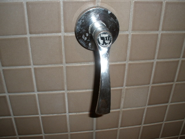

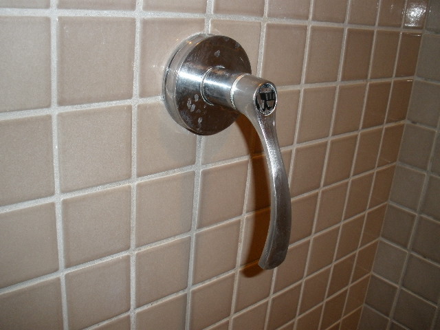

    I have an older (25 year) Dornbracht shower/tub diverter and it has become hard to turn.
    I'd like to take it apart and repair it.
    There is no set screw on the handle and I would like to know how to take thing thing apart.
    Any help?
    21,405
    That graphic at the hub of the handle probably pops out, and the screw holding it in place is behind it. Could be a bear to get out.
