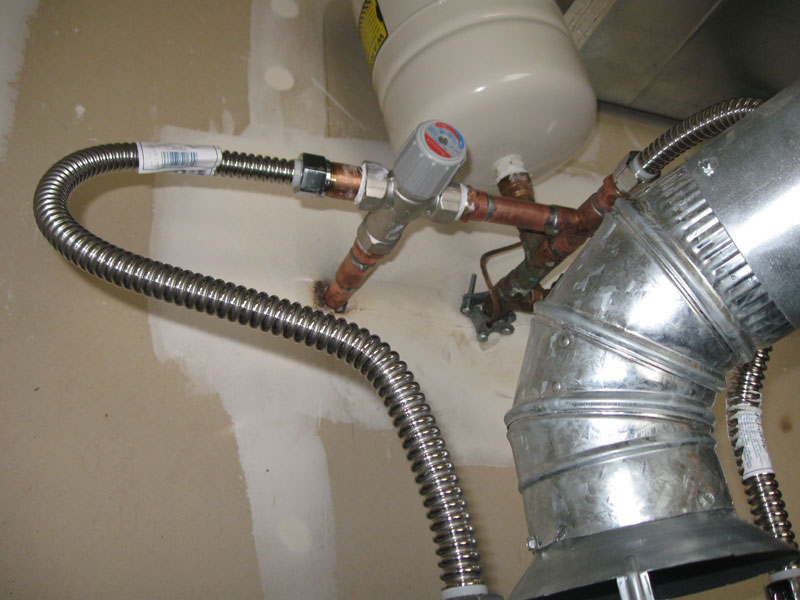

    The only sure way to tackle the bacteria problem is to run the heater at 160 + and install ASSE 1070 tempering valves at the point of use or as close as you can get to the outlet.

    A tempering valve helps moderate the output while providing many of the same benefits. If things like the DW and WM can be plumbed before the tempering valve, you get the best of both worlds. BW has a pre-configured tempering valve setup option that does just that.

    140 F is quite a bit of overkill and I won't do it without a tempering valve--which I don't have and don't see the need to install. So for me the scald potential alone eliminates it. Considering the cost of having such stuff done and how poorly valves (like PRV's) seem to hold up, I'll stick to a lower temp in the water heater instead.
