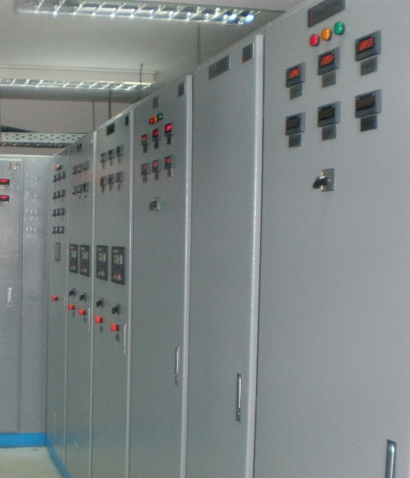

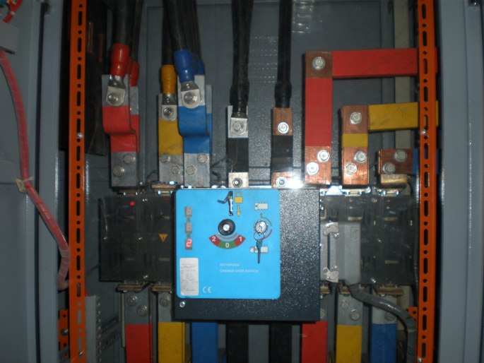

There are 5 cubicals installed which are main Incomer, Phase Correction, Sync1, Sync 2 and ATS from right to left in one row. Copper Bus Bars of 1600 Amps 3P+N and E are running in them. when load reaches upto 800Amps they sounds/ humm very loudely while the Neutral Bus is also grounded separately with 2x70 mm2 single core copper PVC cable.
How this humm can removed/corrected?
Why Humm?

The bars are moving for the same reason that a motor moves. You have to clamp them down, possibly in several places.
