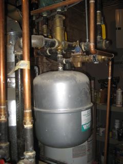

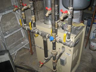

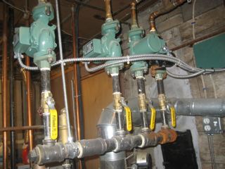

    I 'm attaching photos of the 30" piece of fin tube I want to replace, and the boiler supply and return manifolds and the expansion tank and what I assume is the air extractor?

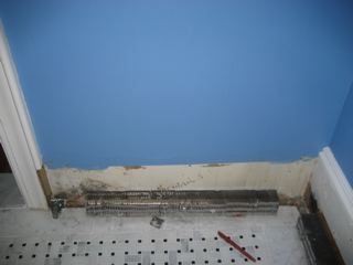

    I'm attaching a photo of the fin tube to be removed. I was going to cut the pipe at the supply side (right) pipe up to the towel warmer, pipe down from the other side of the towel warmer, to the existing return on the left. I was going to replace the existing bleed valve on the left with the bleed valve that comes with the runtal, but I thought I might also add a bleed valve before I go up to the Runtal as insurance.

    From what I can see in your pictures it looks like you have a four zone one pipe system. Are there vents one each section of baseboard? Each zone is valved off so you can just drain the zone you are working on. You can just remove the one section of baseboard and replace it with your towel warmer. Be sure to install a new vent at the highest point on the warmer. After your done open the valves on the zone and vent all the baseboard on that zone. Keep an eye on the water pressure as you are refilling the zone. Some times if the auto feed is old they refill very slowly. If the pressure drops to low you will have to vent all the baseboard on the system.

    I was under the impression you were going to remove the baseboard in the bathroom and use the existing tees. If not then you will need another set of tees in the main, one being a mono flow.

    I was going to remove about half of a run of baseboard. I considered removing the whole run, as the towel bar is almost enough BTU to heat the space, but not quite enough, and with tile floor, 3 exposed sides and flat roof above, I'd rather be safe than sorry. The pipe comes up from the floor on the supply side, the baseboard goes about 4'6 along one wall, turns a corner and then there's another 2'6" stretch along the wall, then there's a bleed vent/ elbow down into the floor. No tees visible above the floor. I can hope that the tees below the floor are monoflow. No way to get to them without opening the ceiling below which I'd prefer not to do.
    Presumably if there wasn't a problem before, there won't be one now.
