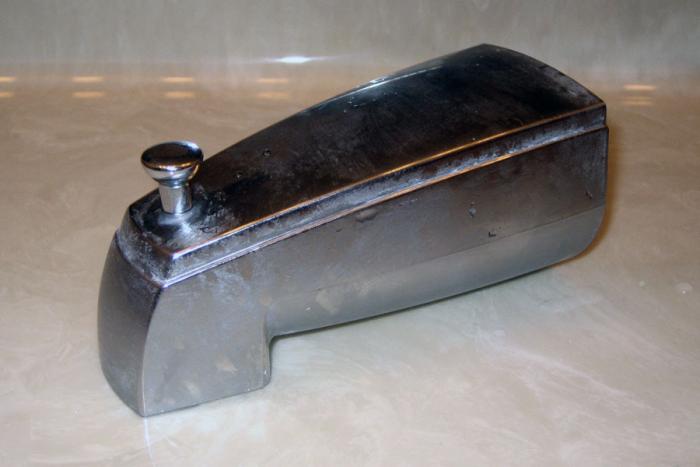

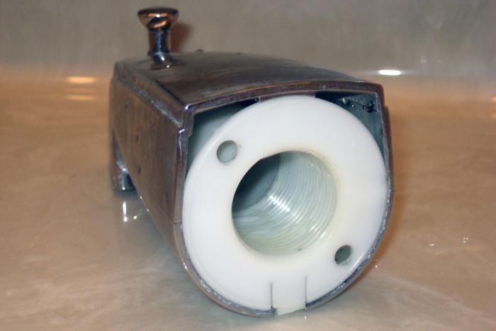

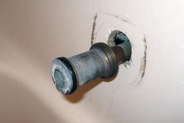

Hey all,
I have two leaky bath faucets that I am trying to replace. As I have now found out, none of the "universal" slip fit type spouts will work for me. Can anyone help determine what exactly I have, or how to find a replacement?
Thanks in advance!!

That is a Delta RP48718 spout. Big box stores may have. If not try a good
plumbing supply.
