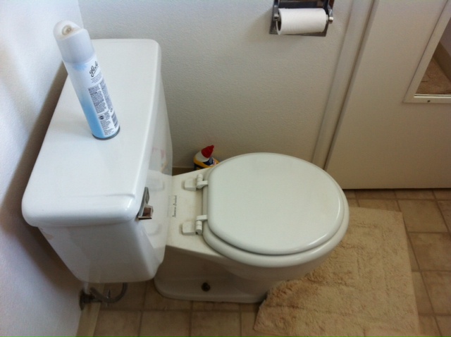

hi. i have been reading here and elsewhere and am trying to become a quick expert! i have an old house with a 14" rough in. i see clearly that you guys really, really like the toto toilets. here is my situation however, my water supply comes up through the floor at 6.5" left of center. if i understand correctly, that is too close to the toilet to work with the unifit system. if that is correct, what are my other options?!
here in central iowa, i have found two toilets within driving distance from me. one if the gerber viper (whose depth is 31"). the other is the peerless madison (whose depth is 27.25"). the peerless is a 'true' 14" toilet in that it does not just have the extra wide tank. ascetically, that would be best for me. did i mention the bathroom is pretty darn small?
so, do i have other options? or to put it another way, are these two toilets really worthless? my current toilet has no name on it, sits 27" away from the wall, and needs plunging several times a week...
thanks!
How close to the toilet centerline does your plumbing go? If the pipe and attachments are centered 6.5 inches left of center, and the max diameter is 1 inch, then you could use a base that was narrower than 12 inches. That could be done. So the pipe diameter and what is screwed into that pipe would be factors.
The Gerber Viper specs well. A bit on the long side for you.
The Peerless I can't find the map score.
It does look like you have a choice of bowls though. The web information is a little sparce.

i went with the peerless (form over function). it fits the space. i will admit it shows the signs of a cheap company: plastic handle, no installation instructions. however, it is still a lo-low toilet (1.6) and it doesn't run. i see this as an opportunity for data collection; i will check in over the next year and let y'all know if its still working. it could be that it doesn't last, it could be that it turns out to be just fine...
That's different: the 10, 12, and 14 inch rough-in use the same tank but different bowl. http://www.peerlesspottery.com/toilet_7160-7161-7164.html
http://www.peerlesspottery.com/toilet_independence.html has the more common same-bowl-different-tank. The description says "Made possible, in part, by the 1st fully automated pressure cast bowl machines in the U.S." Are they new machines, or did they pick up vintage machines? :)
