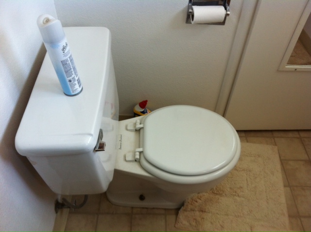

    Default 14" rough in (door opening starts at 30.5")
    I'm looking for a TOTO toilet to replace in my master bathroom which has a 14" rough in. The door starts at 30 1/2" The space between the edge of the current bowl and the wall is 8"
    The 3 that are in consideration are the Drake elongated CST744E, Vespin II CST474CEFG with 14" unifit adapter, and Drake round CST743E (if I must...).
    Here are the problems with each:
    EcoDrake CST744E - according to specs the toilet is 28" and sits 1 1/8" off the wall. In total that would be 29 1/8" but since this is for a 12" rough in I would have to add another 2" making it a total of 31 1/8". I'm worried that the door will hit the edge of the bowl. Is it possible to "skootch" the toilet an inch back?
    Vespin II CST474CEFG w/ 14" unifit adapter - The water shutoff is 6" left of the center and 4 1/2" off the ground. I've seen that Terry has installed these with 5 1/2" clearance. With the valve knob, my clearance drops to around 5 1/2". I'm wondering if Terry's measurement of 5 1/2" includes the knob or is just from the center of the pipe.
    EcoDrake Round CST743E - I'm a guy and prefer to install an Elongated toilet.
    Any advice would be greatly appreciated. Thanks in advance

    The best options are any of the Toto toilets that use the Unifit adapter. These will not only fit the rough-in space beautifully, they are a very good performing toilet and the skirted design makes them especially attractive.
  14. #89
    DIY Junior Member Derrick's Avatar
    Apr 2013
    milpitas, ca
    That's the Vespin II CST474CEFG. I should've put with the 14" rough in unifit adapter. But the concern with that was the water shutoff.
    thanks for the reply!
  15. #90
    Yakima WA
    7,246
    There are ways around that. You could use either an angle valve or elbow that would redirect the supply line parallel to the wall before making the connection to the toilet and of course, you can always cut into the wall and move the the valve. It may also work as it is, just not be as optimum a location as indicated in the installation instructions.
