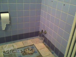

    In some of the older Seattle homes, the old toilets had been wall mounted tank toilets.
    Those typically are 14" rough-in and need a flange repair to use standard closet bolt connections at the flange.
    Everything is on the truck for that.
