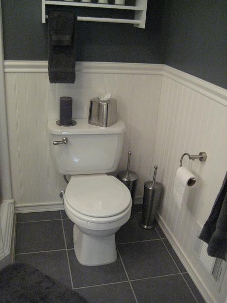

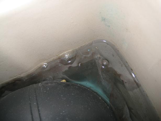

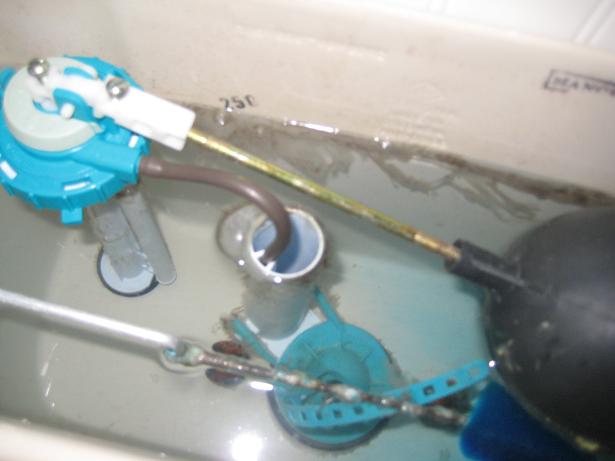

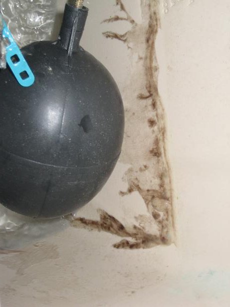

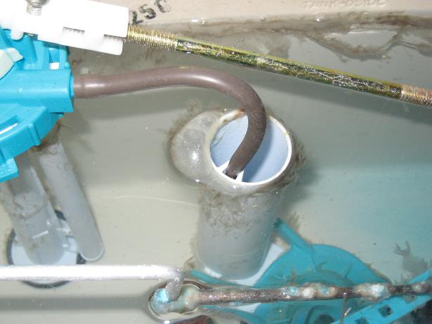

    Here's some photos - pretty nasty, but you can see from the last photo, this is not a nasty bathroom.

    Being that is in the basement and looks clean otherwise, are you just not using this toilet much? I'm wondering if it goes days at a time without ever being flushed and this is allowing bacteria to grow a surface film on the water.

    It could be from the blue puck thing. Add two cap fulls of bleach to the water, sirt it up with the toilet brush as you clean the stuff off everything it clings to. Let it sit 20 minutes and then flush a few times getting all of it out of the tank with the help of the brush.
    Or it could be IRB or SRB (iron or sulfate reducing bacteria). Harmless groups of bacteria.
