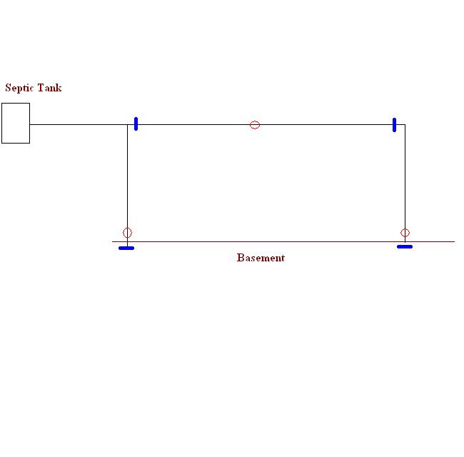

    I recently removed a large concrete patio and plan to replace it with a ground-level deck. The septic line that services the house runs under this area, and I've decided to replace it because it is 35 year old cast iron, it has a leak inside of the foundation wall with several roots in the pipe at that location, it isn't very deep (30" at most), and is convenient to do at this time.
    The line leaves the house at two points and combines near the septic tank. Currently, the only cleanouts are in the basement, which would make a big mess if they ever had to be used.
    I propose to replace the cast iron with SCH40 PVC. All joints will be solvent weld except for those denoted by the blue line, which will be sheilded connectors. I will dig around the cast iron pipe, but not under it, to retain the proper pitch and bedding. I want to back fill the pipe with sand, followed by some class-2 fill , then native rocky-gravel fill on top of that.
    I plan on adding cleanouts at the locations denoted by the red circles.
    Does this sound like a good plan? I checked Wisconsin code, which indicates that septic lines don't need frost protection within 30 feet of the foundation.
    Thanks in advance.

    It looks good to me. Just make the clean out in the center a two way so it can be snaked in either direction.

    You might run the far line over to the close one either inside or just outside the basement wall and save some digging.

    johnjh2o1 : That's a great idea, I'll be sure to use that fitting.
    leejosepho: I'd like to do that, but the basement is finished. Also, other utilities in this area make moving the pipe closer to the house rather impractical.

    DO NOT USE A TWO WAY CLEANOUT FITTING. Use TWO cleanouts at the building, and eliminate the one in the middle of the line. Can you angle the right hand line on a 45 after it leaves the building to make a more direct flow?

    What is wrong with a 2 way? Just that if you REALLY need that cleanout it will be because it is full of water and getting your snake to go the proper direction can be a pain. The only "good" two way cleanout is one in the scrap bin. Why would he need it since he has cleanouts at the house which will snake past that point?

    I decided to put the cleanout at the far end instead of the middle, which would have been under the deck. This way it will always be accessible. There's also another cleanout right next to the foundation.
