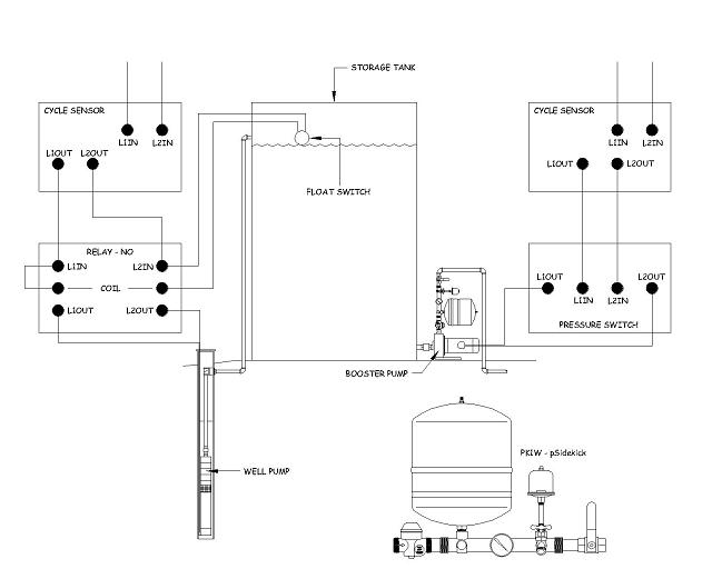

My well goes to presure tank and out to home. I want to add a 3000 gal storage tank Because I have a LOW YEIL well. Question is I do Not Know How to which float switches I need to stop well from pumping or get it started when low, plus how to wire the floats to th system. I will use a cycle timer to run the pump for 5 minuets and off 1 hour. PLEASE any Help, Thanks Fred

You will need a 2 pole contactor. The float in the storage tank will control the contactor, and the power from the contactor will control the timer.
If the float says its time to fill the tank, it will turn the timer on and let the pump run for your set time limit, and will continue to cycle through your set times until the float says the tank is full.

I can now run the well system only 24 minuets till the water stops comeing out the hose. My thinking is to run open water line from well to tank, also using a timer to regulate running time of well to keep from running the well empty all the time and causing damage to well and pump.( I just don't know how to get the well to stop pumping water after it gets full or when it get empty to start again, timer will allways but well will not run till low or full is what I am trying to find.
I want to pull from storage tank to pressure tank with pump and go to home (ie) use storae tank instead of well.
I run out of water 4 = 5 times day now.
I have 3000 gal storage tank in place and lines ran from well house to tank.
I will still need to purchase a 3/4 or 1 hp pump and cycle timer and float switches.

OK how about this, I have a QD Pumptec with 3-9-12-30 minuets and 1 - 1.5 hours and Manual Reset. I I just let the Pumptec do the timeing of the water and add a Float switch to the storage tank where do I wire it to (control Box) or ? I do not understand where to wire it to ?

That looks ok, but you still need to wire the timer into that.
Where your drawing says relay, that can also be the contactor (That needs to be able to handle around 15 to 20 amps)
That is why I suggested a mechanical 1 hour timer.(they can be set in seconds to 5 min or what ever you may need for your wells production)
Even if it cuts power to the timer, when it comes back on, no harm done, no time lost, and nothing to reset.
This is just the way I would do it. There may be better ideas out there.

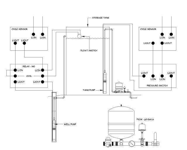

Here are a couple of drawings that might help.

Hi Fred
You don’t want to use a regular timer. It will not shut the pump off when the well is dry. If you set a timer for 10 minutes and the well pumps dry in 5, you are going to ruin the pump. You need a Dry Well protection relay like the Cycle Sensor, it has a restart timer built in.
