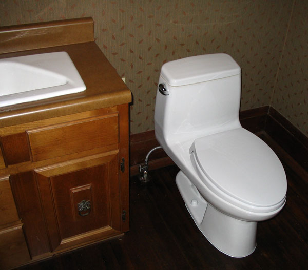

    This is a white Toto Gwyneth (now called "Ultramax II, I believe) I installed this spring in our bathroom. I think it looks good against the dark tile.
