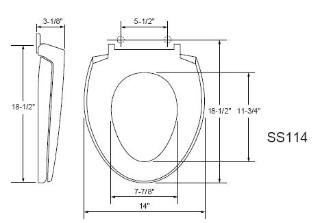

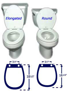

A couple years ago when we did our bathroom remodels we had a Toto vespin installed in our main bathroom. It's so far been a great toilet. We recently potty trained our oldest son and want to replace the seat on this toilet with something like this temporarily so he won't feel so much like he's going to fall in:
http://www.pottytrainingconcepts.com/Flip-Toilet-Seat-DRE.html
Will a "normal" elongated seat fit on this Toto toilet? Anyone ever installed one of these before?
Peanut9199
869
Ontario, Canada
Yes any elongated seat will fit your Vespin.
The Toto seat is 18-1/2" long and 5-1/2" for the bolts.
The same as the seat your looking at.
SS114 Toto seat
