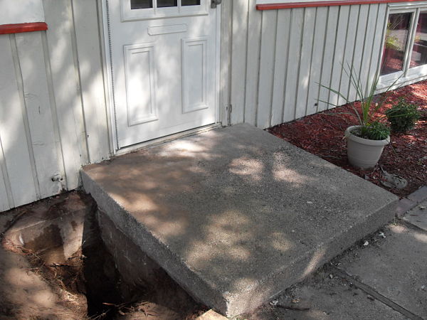

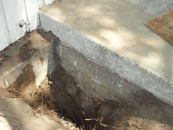

After further research it seems likely that the well is located under my front step. This is based on some documentation that another neighbor had. It shows the location of the well as under the front step. They have the same house built the same year. Their well depth is recorded as 182 feet, ours is 178 feet. I dug down next the the step and there is a wall going down seven courses of block deep. The jet pump is located just on the other side of the basement wall. Apparently this used to be common back when the house was built in 1971. So now I need to remove the step to get access. Not sure what I will see or if I will need to do any more digging. If the well is indeed located there it would make extending the well casing above grade more difficult since the step is there.

That discovery, my friend, to put it mildly SUCKS. I take it your discovery has lead you to let sleeping dogs lie ?

Unless you are positive that the well is under the slab, you might want to dig out in front of the steps to see if the lines go on out into the yard.
Otherwise you remove the slab to get to the well. You have a pit type well, under the slab. Remove the slab and you probably will have a cement walled box 4-5'+ deep with the well in the middle of the floor.
If you're creative, bust the wall out around the pipes and see if you don't go into a small room, under the slab.
Removing the slab shouldn't be very difficult, unless you've never done anything like that before. A couple strong ground pin type steel bars to raise it (or a backhoe) so you can get a thick walled pipe under the front edge and some way to pull the slab away from the house, rolling it on pipes. Then you roll it back when done.
You won't be able to raise the casing unless you cut a hole in the slab that can then be covered. That would also require a pitless adapter which you probably don't have now. A pitless would be a good idea and then you wouldn't have to remove the slab in the future; just the slab hole cover.

1st, though it would be nice to extend the case above the steps, it would be a pain in the you know what considering the times that you may have to access it.
2nd If you know the make/model of the pump, you should be able to get a pretty good match for the jet that is in the well.
3rd The set up is working now so why make work for yourself.
Now that you know where things are, relax. Even if it craps out in January it won't be much more difficult to service it then.

I'm thinking it would be possible to extend the casing to about 10" to 12" above grade. Then replace the cement step with a small deck using 2 x 10 joists. Could be made to look nice. Then the well head could be between the joists and could be accessed by removing a couple deck boards. But yes, now that I am almost positive I know where this thing is I have a couple other projects to get done first.
