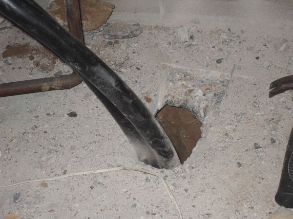

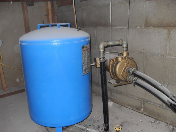

    I would like to upgrade my 1/2 hp convertible jet pump in the near future. According to all documentation that I have and what I can see in the basement, the well seems to be located under the house. The house was built in 1971 and the well driller is now out of business. I talked to my neighbor who has lived here for years and he says that the wells in our development were drilled and the houses built over the top of them. As I understand it, I will need to replace components inside the well when the jet pump is replaced. All that can be seen from the basement is the two plastic lines going from the pump through a rough opening in the basement slab. I have no idea how far down the top of the well is. My plan is to bust up some concrete around the opening and dig down to find the top of the well. My questions are: How far down would the well typically be in this situation? Do I need to extend the well casing above the slab, if so what is involved? I am located in Andover, MN.

    The opening is only about 3.5" in diameter, just big enough for the two pipes to pass through. What would be wrong with the well that would make me better off with a new well?

    Technically speaking, if I were to replace my 1/2 hp pump with a 3/4 or 1 hp pump without changing the jet or anything inside the well, what would the potential issues be?
    6,356
    The jet and pump have to be matched. IOWs you need the right jet and nozzle for the pump, and increasing the hp with a 1/2 hp jet etc. is not going to work well at all.
    Well like yours that I have seen usually have the casing up out of the floor a few inches and use a sanitary seal. Maybe your casing has sunk.
    Maybe you have a 3'-4' hand dug well and the cellar floor is above the lid.
    My experience with odd well construction, like a well in the basement, is that the people, banks, real estate folks and prospective buyers in the area are familiar with them and it isn't the problem that guys here from areas where they aren't used go on about. But then Ive never heard of a drilled well under a house!! but it is MN where they tend to do things more than a bit different at times...
    You can extend the casing above the floor if you find one and can get down in the hole if needed to work on it. I would use a Fernco fitting and the same ID sch 40 PVC as the well casing. Then a sanitary well seal.
    A larger pump may not do well if the well can't produce the volume of water you will use.

    I am really starting to get curious about this. Last night I tried to look down around the pipes through the slab. I could not see much because the hole through the slab is not much larger than the two lines. What I can tell though is that directly below the slab where the lines go through there seems to be about a 1 cubic foot hollow area. Not sure if it was boxed out with plywood or what but I can see dirt. My next step will be to get a diamond blade on an angle grinder and cut out some of the slab so I can see what is below.

    The information I have been given was all wrong! After making a larger opening around the piping it is clear that the well is not located below the slab. I can follow the piping down and feel it go horizontal under the foundation. So now it looks like the well is somewhere in the front yard. Now the question becomes, how do I find the well now? I have several trees in my front yard and I hope to hell one of them is not over the well. I sense a lot of digging in my future.

    It is a split level house. When I am standing in the basement, ground level is about waist high. I think I will leave it alone for now, at least until my curiosity gets the better of me again.
