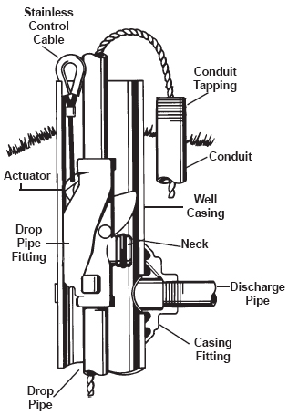

    This is most likely what you have down the well. A standard pitless puller will not work. You need to have both the cable that pulls the latch up and the cable that keeps the pipe from falling down into the well. If the latch cable is not there you will need to fabricate a hook. Also make sure there is another strong cable attached to the drop pipe. You may very well want to have a well company come out and do this as they will have the hook.

    The adapter I have looks similar to that drawing.The "actuator" lever doesnt appear to have ever had a cable on it. I've tried everything to get this dang lever to release but I'm not sure if it needs to go up or down.I made a hook and tried every thing I could think of with no luck.Any suggestions?

    No help here, I've never seen anything like that before. Maybe you have to pick up the weight of the pipe/pump before it will 'unlatch'.
    I've used a prybar,tried turning it with a pipewrench,tapping with a hammer while prying.I've tried both lifting and pushing down on the lever but it doesn't move.I'm afraid I'll break it and really be screwed.I've searched the web to try to get a better idea of how its supposed to work but I havent found anything like this piece of crap.
