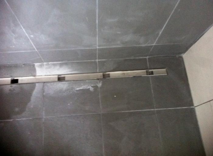

    Not being a person in the business or done a linear drain before, can you point out what is the problem with the shower?

    You want the water to drain into the drain! It appears that water would tend to pool between the wall and the drain, assuming the slope is from the main area into the drain. It could get there by splashes or directly from the showerhead. You'd either need to reverse the slope on the wall side to the drain, or move the drain next to the wall. Then, it's best if the drain is the full width, as you might get the same pooling at either end.

    You can see the residue from the setter cleaning his tools in the shower. When we cut out this failed Kerdi Shower we discovered that the PTrap was 3/4 full of mortar.
    In the back corner the tile is sloped in a way that it does not drain very well. It is hard to achieve proper grading and meet industry standards in lippage.

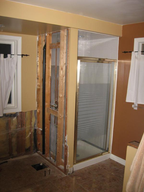

    John, Another gorgeous shower. We are looking into the very same setup for our ensuite reno. Corner glass walled curbless shower and freestanding tub exactly as you show it. Am struggling as to how to make this possible. I've attached a picture of the half torn out bathroom. Name:  Ensuite Bathroom Reno 009.jpg
    Can this be done without a curb and without cutting the joists? I'm in Ontario if that helps.

    Unless you can raise the entire floor, to construct the shower pan, it MUST slope from the entrance to the drain, and since that needs some thickness, it has to come from somewhere.

    Assuming that I dropped the floor down the thickness of the floor which is 5/8" OSB and then added the drain and 3/8" for slope change ( 3' x 3' shower, drain in center). So say top of lowered floor to top of drain would be 1.25". Then add 3/8" for slope and you are at 1 5/8" from lowered floor or 1" above the floor of the remainder of the bathroom. This would be for no curbs at all.
    Alternatively, I guess I could put a full 3' linear drain at the front of the shower at the door at the level of the finished bathroom flooring and slope the shower up 3/4" (3' x 1/4") to the back of the shower and add a curb to the left side of the shower. Would then have a curbless "entry" at least.
    Do you think these 2 approaches would work and do my numbers seem correct?
