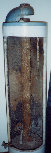

    Quote Originally Posted by Runs with bison View Post
    In other words, Dunbar, you've got nothing. You refuse to back your claims with anything concrete and those of us with different experiences should believe reality is only what you say it is in your area.
    I'll do you one better. I'll continue to track this water heater's gas use until it fails (or I replace it) to see if/when it tumbles. So far water heater gas use is down about 33% in the past year (from 18 therms/month to 12), but I've been reducing wall/pipe losses and hot water consumption by various devices/appliances. I'm approaching half of the Energy Guide rating.
    I'm still scratching my head over your electric water heater claim... How again is the electrical efficiency lost? Sure the elements will burn out and quit working, but nearly all of it from beginning to end is going into the tank because it is a resistance heater. The tank can be full of sediment but the heat is still going into the water. The only other place it has to go is surface losses...which are not changing much. Ask an engineer buddy how to draw a box around a system, it's one of the first things you learn.
    Now if one really wanted to prove a point about efficiency losses in the gas fired heater, the solution might be in measuring flue gas temps. If the efficiency falls dramatically that heat has to go somewhere during burner operation. And that somewhere is up the flue in a traditional non-power vented model.
    Efficiency loss is not necessarily the same as poor recovery or lost working volume.
    I'm not "preaching 20 years." Unlike you I don't pretend to know when the water heater walls will begin to leak nor how rapidly efficiency will decline. I'm not trying your "one size fits all" approach.
    If efficiency fell off as rapidly as you believe, energy conservation sites and greenies would be all over it.
    First of all,
    I'm not the 5 post wonder you are.
    Secondly, I moderate/admin plumbing forums across the internet, but I just started plumbing last friday.
    Second, you don't "grasp" sediment that lines the bottom of a water heater on gas models
    you don't "grasp" electric water heaters that can have sediment issues that reach the lower element which is the worker bee of the tank in producing hot water, that when it is submerged in sediment like the picture above shows...the energy guide is wasted print on the heater.
    Comprende? Si?
    Run with Bison,
    Have you never seen an electric water heater element pulled out of an older, sometimes relatively newer water heater at times when a layer of sediment bakes itself to the element, and you hear what sounds like bacon sizzling when the upper thermostat calls for action and you know your water heater is operating?
    Are we on the same planet or did I make a wrong turn at Mars today.
    Do you think that efficiency isn't lost when buildup is on the elements OR in the bottom of the tank?
    DO you think Master Plumber Mark shoved oatmeal in that water heater to make up stories?
    Are you serious?
    So, when a tank's capacity is lost due to mineral buildup, and the conversion is.....wait.
    You fill in the blank. You tell me what the conversion is for capacity against ready to use hot water, figure out the # of gallons and then tell me what's the factor used in consideration for doing conversions from gas to electric, electric to gas and what needs to be increased or decreased when doing so.
    Did the picture above your post ever make you think that sediment can bury the bottom element...???
    Never heard of scale/lime buildup on an element?
    You mentioned burn out and quit working...wouldn't that be a dead end statement in reference to knowing that it's going to be instantly replaced to make it operable? Hello?
    "The tank can be full of sediment but the heat is still going into the water" Name:  images.jpg
    What happens to thermal transfer/dissipation when someone cooks food and beans burn in the bottom of a pot? It traps it, interrupts the cycle of heat rising to the top like all water heaters are designed to do...
    that's why cold water enters the tank through the dip tube,
    that's why electric water heaters operate by the lower element to heat the incoming cold that rises to the top for the ready to use hot water,
    the top element is only for sustaining ready to use hot water when the heater has been inactive for a period of time.
    The statements you're making are easy to blow holes through with how much you don't know about the operation of a water heater.
    "But my dad works on computers, and he's got tools. We can use his tools and fix things."
    If you're going to dance with me, at least dance to the same song with me.
    Now I have a reason to use my camera more effectively so the proof is in the pudding to reference what I already know.
    You're going to get charged for the ear plugs for every water heater I cut open for the visuals so this "unknown" by years of knowledge comes out and people can point and giggle at the empty statements I just filled for you.
    It almost sharpens the pencil for me, it really does when reality and perception get mauled over by someone who can type and argue. I'll be waiting for your response on what you should know in the paragraph above to see if I should stop.
    No, I can't do that, I got pictures coming! Whoops, here's one with a little more of that non-efficiency rust buildup:
    Name:  WAH-WAH HEATER.jpg

    This is why it can be so hard to communicate with techs/tradesmen, they routinely misapply theory while scoffing at edumacated engineers. Let's review how to draw the box:
    Energy efficiency is a measure of how much energy goes into the water versus how much ends up going to the surroundings (flue losses, piping, walls, etc.) If it goes into the sediment (see electric) it is still in the tank with the water. The energy still has to get out either with the water or out through the walls/piping. The effective capacity of the electric heater goes down as the element fouls and if sediment gets high enough to cover it, etc. Efficiency does not. Unless the water in the tank along the walls is much hotter than before, the losses to the environment on electric are going to be essentially unchanged. If you lost X watts out the walls and piping before you will still lose X watts. So for a given amount of hot water usage, your efficiency will be unchanged. Now if you crank up the temp to compensate for lost capacity, you will see greater losses as the delta T to ambient is greater. However, considering that standby losses for electric water heaters are small (90+% energy factor), you won't see much decline in efficiency even then. You are likely to hear complaints about the hot water running out early...been there, done that. Funny thing is, the water heater can work like crap...but still get about the same electrical efficiency per gallon of heated water.
    I've pulled out enough electric elements that I have some feel for the sedimentation/scaling aspect. Never had to replace one of the tanks though...they seemed to live on for the dozen or so years I lived with/serviced them. I've scraped out a lot of that carbonate in the bottom. I do recall the capacity dropping off, which was an indication the "death spiral" had begun and that I would soon be replacing the bottom element.
    The death spiral in a nat. gas heater will be different than an element failure. Sure sediment will reduce capacity and recovery time at some point. An efficiency loss will result and the wall temps will be higher than before. The question is one of degree. Until that burner is having a really hard time heating the water the energy efficiency is not going to change much. Water's ability to transfer heat is a wonderful thing for those of us with heat exchange design experience. Heat transfer coefficients on the liquid side of an exchanger tend to be an order of magnitude above that on the non-condensing gas side--two orders of magnitude when phase change is occurring. This will handle some scaling before efficiency suffers appreciably. When heat transfer does begin to suffer appreciably the tank is likely starting a death spiral. Flue temps will rise (something you can measure) because the burner will be firing hard, but the heat transfer coefficient is plummeting. Wall temps in the flue will shoot up and the exiting gas will be hotter. This will increase corrosion rates on the flue walls/base.
    You can't predict when a wall failure will occur due to corrosion because there are so many types (particularly the exterior wall failure posted earlier--hint: it's not the heat transfer surface, looks like the external weld seam but I could be wrong.) I've seen and troubleshot enough different corrosion/cracking mechanisms in many types of systems and metallurgy (including several grades of titanium, several types of hastelloy, duplex stainless, monel, inconel, brass, copper, aluminum, silver as well as differing grades of stainless and carbon steels), so I know better than to make some sort of bold statement about when something must be replaced without inspecting it.
    Putting a six year life on it wasn't smart to begin with because use will also factor in. If one is firing the thing hard and long, cycling it frequently, and/or running high tems I would expect the sedimentation rate to differ from one being run milder. Then there are other factors such as location (water chemistry), maintenance, and water softeners.
