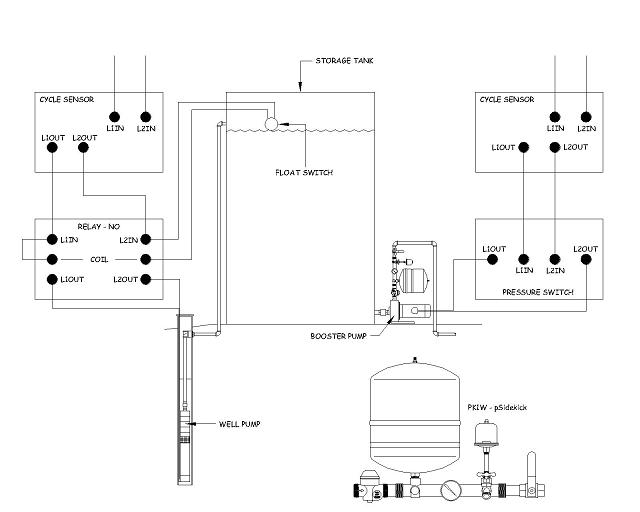

I have a ten year old well 240' deep with a Franklin submersible pump. It has a Well Rite 140 OLC pressure tank and a Square D pressure switch. 250' to house, 125' of 1' then 125' of 3/4". It averages 8 GPM; pressure gauge reads 30lb when pump is on. Pressure has always fluctuated with poor pressure at the house.
Pump will run out of water if you run it for more than 30 minutes. Water is undrinkable, leaves buildup on all faucets, shower heads, toilets etc. Hot water heater, washer and dishwasher average 3 years before replacement.
I now have the budget to upgrade the system but, not the budget to pay to have it done. I plan to install a 550 gallon holding tank and reduce the flow to the tank in hopes of not running the well out of water. Then install a jet pump to increase the house pressure and hopefully stop the fluctuating pressures. I have spoken to two plumbing suppliers and have two different ideas on how to set it up.
I made a drawing of the last guy's idea but I'm not sure if I got everything laid out the way he explained it to me or if all the accessories are correct and in the right places.
A couple things I'm not sure of:
He said I would need an UP float valve and a DOWN float valve?
I'm assuming the pressure switch at the submersible pump controls it. What turns on the Jet Pump or is there a certain type of jet pump required?
Would one of the Constant Pressure Valves help my situation?

Here is a drawing for you. The CSV goes on the booster pump so you can use a small pressure tank, and to hold the pressure constant so the pump does not cycle on and off.

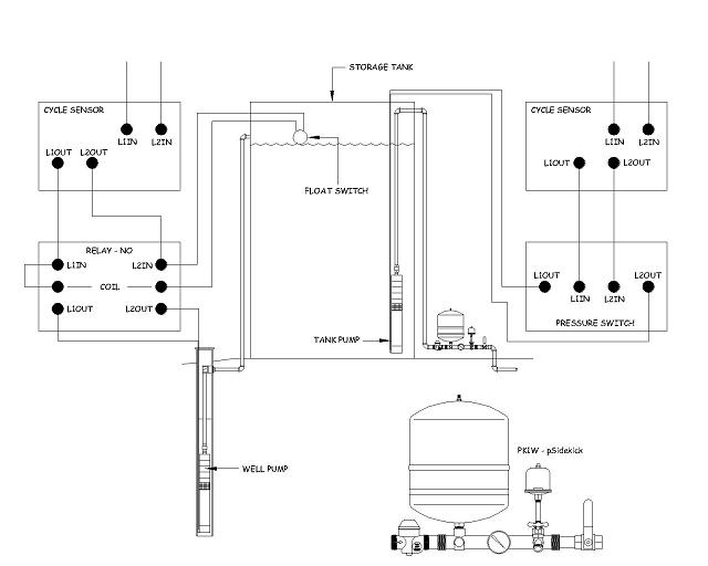

You can also use a submersible in the storage tank. It will give you better pressure with lower horse power.

Excellent, you pretty much summed it up for me. I appreciate the drawings too.
What type of submersible pump for the tank?
Type of float valve for well submersible pump?
CSV?
Where do you recommend purchasing items?

Probably a 10 GPM, 1/2 HP sub will do. However, you can have as large a pump as you need. The pump can be sized to the peak demand of the house.
Do a Google search for CSV1W, CSV1Z, Pside-kick, Cycle Sensor. You can find some good pricing on the Net.
We use the Cycle Sensor instead of a safty float switch at the bottom of the tank. The Cycle Sensor looks at low amps and knows when the tank is empty, instead of using a float switch, but either will work.
We also use the Cycle Sensor to protect the well pump from dry running.
Float switch is a regular sump pump type float switch, very common.
Contact me at the site below if there is anything I can help with.
Cary

On the submersible pump for the tank, should it be 115 volt 2 wire or 3 wire. I read the 3 wire requires a control box. But if you don't have a control box what do you hook the float switch to?

I prefer 240V because the amperage is lower. Two wire or three wire is fine. If you notice in the drawing there is a relay that is controlled by the float switch, and it cuts the power wires to the motor. If it is a three wire motor, it just cuts the two power wires to the control box.
