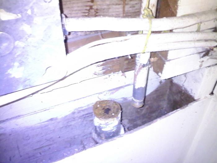

    Get rid of all the galvinized pipe you can. If its from the 40's, its most likely corroded somewhere...like this...at my cousins house my brother is doing a side job at!
