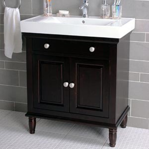

    Finally, in selecting "Cotton White" or "Colonial White," which is the better "generic" white? We purchased this vanity, which as a very creamy, bright white sink.
