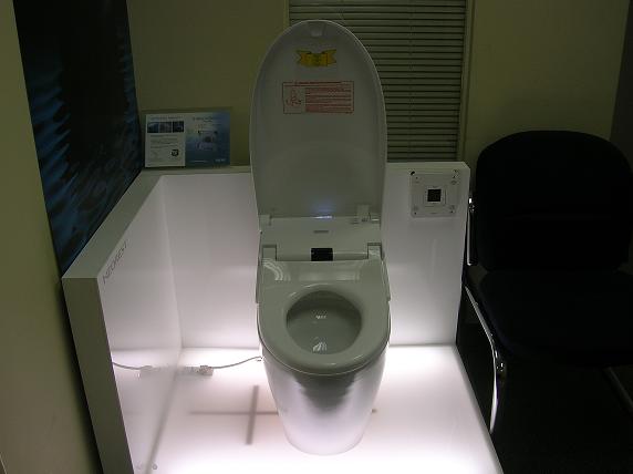

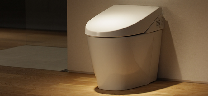

    On display at my showroom, very nice unit.

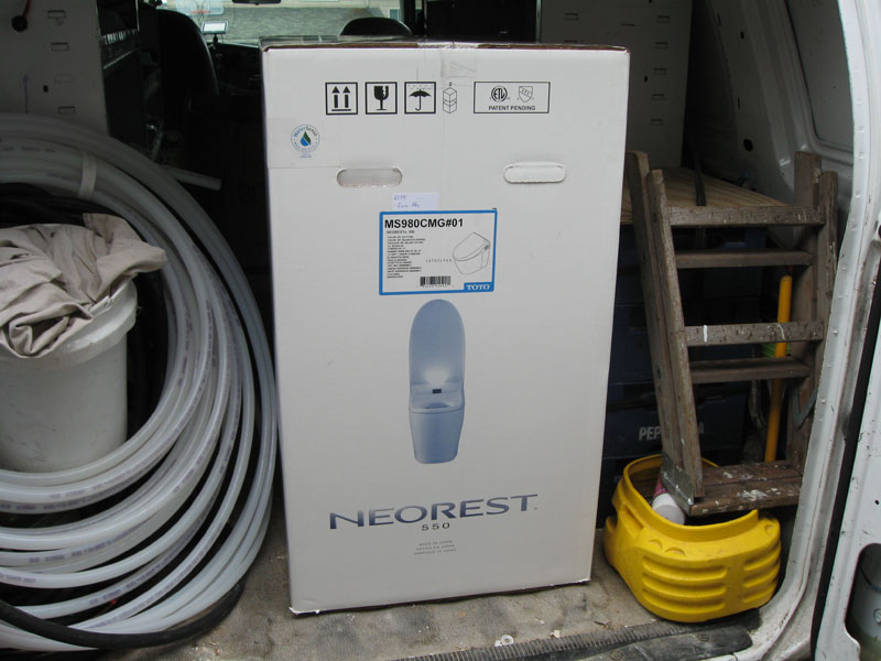

    Default Neorest 550 Installation

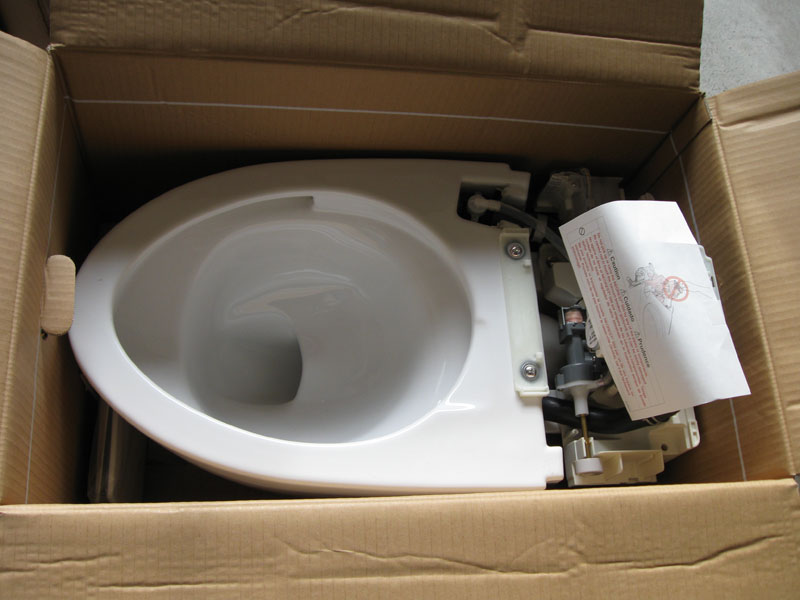

    Bringing a Neorest 550 to a customers home for installation

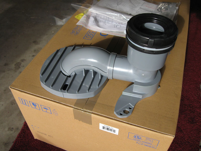

    In the box

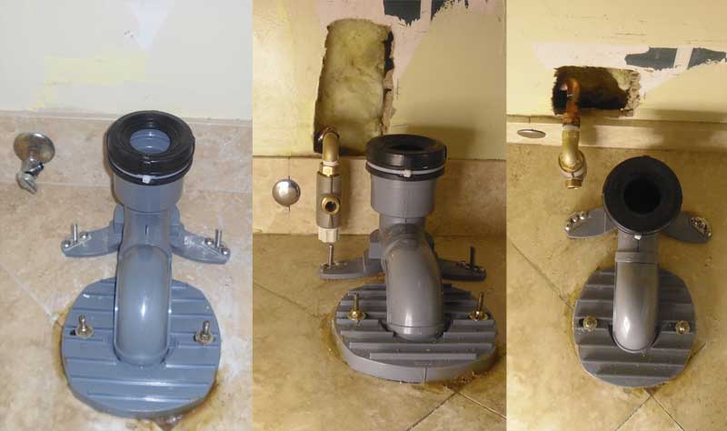

    The adapter that connectos the bowl to the closet flange.

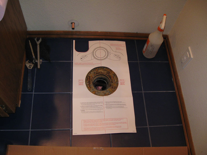

    Using the template to locate and drill through the tile floor.
    The water supply will need to be moved behind the bowl.
    There is more drywall being done, so this hole in the drywall with be patched and texturered with the rest of the remodel repairs.

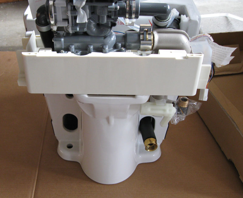

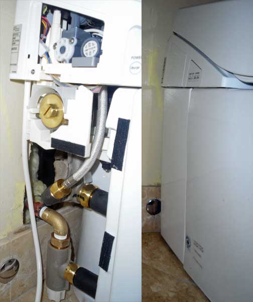

    Here is the back of the bowl.
    And here is the connection before the Velcro attached panels are installed.
    The Drywall will be patched.

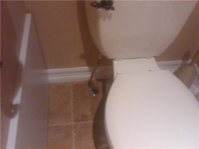

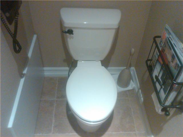

    So I am thinking about ordering and installing a TOTO Neorest, and I have a couple installation questions. I jointed this forum just to ask about the TOTO. First off my water supply (Zurn Pex) comes up thru the floor and is, thats how they plumb here in this part of Colorado very seldom do we see a toilet water supply thru the wall, does the water supply have to be thru the wall? Does the water supply have to be in a certain location in respect to the TOTO unit? Can someone explain anything based on the attached pictures? Attached are 2 pictures of the toilet I want to replace in question. I will hire the plumbing out, I'm an electrician by trade and don't pretend to be a plumber.

    The instructions for the Neorest 550 show the supply coming through the floor.
    Either the wall or the floor will work.

    Alright, I was just a little concerned about clearances so that the waste pipe and water supply don't have to be relocated. I am hoping this is a run of the mill toilet swap and not a full blown remodel. So for the TOTO if the water supply isn't in the ideal perfect location as your pictures on the template show, can the TOTO still be installed without relocating a water supply? Are you relocating the water supply to make the install look great or for function I guess is what I am asking?
    Final question for now, how well does the TOTO match existing bisquit colored bath fixtures? I like the idea of a remote control toilet, the wife is more concerned about everything matching.

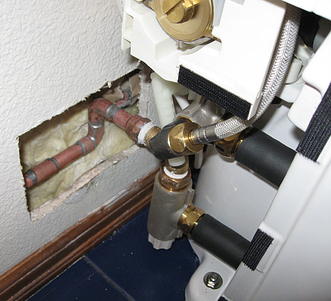

    The Sedona Beige is very close to Biscuit.
    The Neorest 550 has side wings that Velcro on, so it makes sense to move the valve within that area, otherwise you have to cut through the panels for the water supply.
    It's not major, but I do allow 4-5 hours to install one of these.
    You can see in the picture here, that the valve could be been in the opposite direction.
    The connector from the bowl threads on, and it doesn't care which direction the shutoff is installed in.
    The knob can be low near the floor, or on the high side, away from the floor.

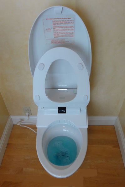

    A Neorst installed in Seattle. After the picture was taken, we pulled the cord in a little tighter.
    I put some blue color in the bowl so I could take a video, but the battery was too low on the camera for video.
    You can see the night light is on.
