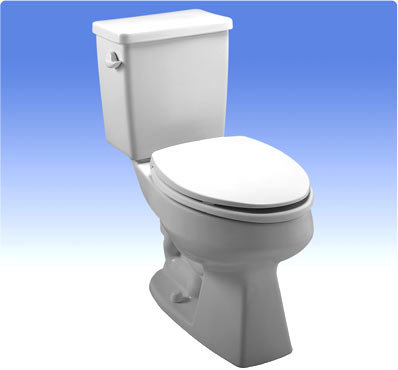

    We need to replace an old toilet in our 1938 house (although the toilet itself is not from 1938). The bathroom is very small--seriously just enough room for a vanity, a toilet, and a bath: about 5x8. The rough-in is 14" and the plumbing is not new (in another post I made, I noted that one site said that only a skirted Toto could be used to unifit for a 14" rough-in). Our current toilet (a basic American Standard) has clogged several times, but I'm assuming that the problem is the toilet and not the plumbing. We would like to get a low-flush but have been told that they are not powerful enough to flush in one flush and that they don't work well in old houses. I was also told that round-seat toilets do not have as strong a flush as elongated toilets. The ones we are looking at are the Drake, the Dartmouth, and the Promenade (although I've read that the Promenade is a bit loud). Sana-gloss and G-Max would be great--but again, maybe too much toilet/power for an old house/plumbing? In terms of cost, we don't want to spend a fortune, so the higher-end Totos are not an option.

    When you have to have round front your limited and then 14" your getting worse.
    The Drake and Promenade are not 14" and the Dartmouth is only available in Elongated rim.
    If you can fit an elongated bowl than your options are more open.
    The only thing i can think off is to use a C733F Dalton Bowl which is round front and Universal Height, but no Sanagloss or G-max.
    Then use the ST701 Reliance 14" tank.
    http://www.totousa.com/ProductDetail...7-d465084608f8

    Round bowls are going the way of buggy whips. With the new tank sizes brought about by low flow requirements, it is now possible the have an elongated bowl that takes up less space than some round bowls. Elongated bowls are male friendly and are available in every model of toilet. Round bowls are not available in some models, so your choices are greater with the elongated bowl. I seriously consider the ADA or comfort height as well.

    If you want to spend the least, pick up a standard 12" rough toilet.
    If space is important, consider moving the bowl back with an adapter.
    Your closest distance from the wall will be with a skirted bowl with a 14" Unifit.
    The other brands will use a 12" bowl, in the middle of the room and a thick tank. Save a buck, use the 12" bowl in the middle of the room, and the standard tank and don't worry about the space behind the tank, it's less money.
    But if you really want to "pull" the bowl closer to the wall, spend the money.

    The only way to save room in front of the toilet is to choose one of the Totos that use the UniFit adapter (this would be one of the skirted models). This actually moves the entire toilet back 2". All other brands accommodate the 14" rough-in by making the tank thicker, and leaving the bowl stick out further into the room than necessary. This will save you 2" over another either 12" toilet or one configured for 14".

    Thank you, Jim. We did decide to select a Toto with the UniFit adapter. If we had a larger bathroom, we probably wouldn't care that the toilet was 2-3" away from the wall. But in our tiny bathroom, I think it would look weird.
