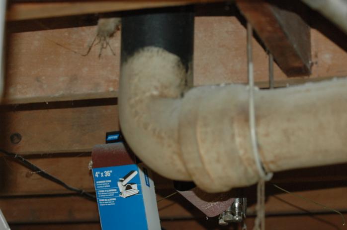

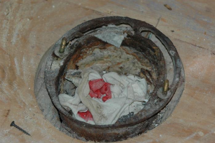

here's what I have left for a toilet flange and the connection into the main waste line. i'm guessing that the flange needs to be replaced - what's the best way to go about doing this?

That is an offset collar, and the worst kind of offset collar at that. You have to figure out WHY they used it and if it can be eliminated. If not you might be able to use a standard one with a different toilet.

Looks like the closet bend is right up against a floor joist. that would be why the offset flange.
mwalsh3
I'm at work right now, but from what I remember there's about 2" of space between the pipe and floor joist. Does that help me at all?
Thanks
