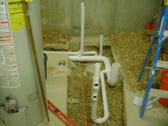

    Default Bathroom rough in move
    Hi everyone. I just moved a bathroom rough in, and was wondering if everything looks good to you. Please notice from the picture that the longer pipes are the vents and I used combination wye tees on the 4" toilet pipe and the 2" shower. The sink drain has 2 san tees as we are planning a wet bar around the corner. The main drain is around the back going into the original rough in toilet pipe. Thanks
