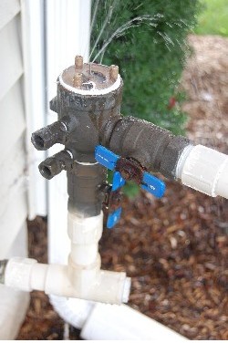

I finally got pictures of the leaking Wilkins pressure vacuum breaker. You may notice teflon tape on the bonnet circumference.Wanted to see if it would help any and of course it did not.
The unite is a 720A and as some have said I think I'll need to replace the whole thing but wanted others to see this first. If I need to replace it I will post another picture showing the connections so I know what kind of PVC parts to purchase.

As I look at the picture you posted it looks like the bonnet might not be screwed in all the way. I can't tell for sure-- the picture might be playing tricks on me. Here is a picture that I took of a new one. Notice how far the bonnet is seated into the body.

Get the teflon out. Is the o-ring and big plastic washer installed? Find a diagram of the internal parts to make sure you have them all installed correctly. Otherwise, install new one or get a pro out to your place.

Will remove the teflon tape. I did replace the o-ring and plastic washer. But looking at the picture posted by onedrop makes me realize I have not screwed the bonnet in far enough. Just how tight is it supposed to be? Maybe I'm a weakling but hand tightening the thing is not enough. Now I can use a wrench to get it in tighter but just want to make sure that's the thing to do

As suggested by Tomm, remove the teflon. The bonnet is sealed via the "o" ring. The bonnet should thread in by hand until the "o" ring comes in contact, then give it a little extra tightness. You should not have to crank down on it with a big wrench. Compressing the "o" ring is what seals it. If the bonnet does not screw in relatively easy and flush with the top as was noted also then I would say, as others have suggested in previous posts that the body is warped from being frozen and you need to get a complete new unit. Good luck.

I agree with BRD. You should't have to use much force to crank it down. So, if its is taking that much effort it leads me to believe that it doesn't fit correctly because the body is likely warped.
