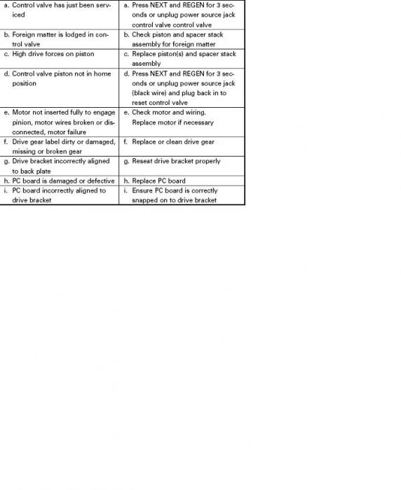

    Getting the readout- error call 1002 . i got the softener from the wonderful folks at 3rd coast who won't answer their phones, the other thread hints they may be closed? My book doen't go into what the codes are and what to do about them.

    Error Code 1002, Unexpected stall.
