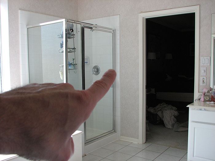

    Anyway, I still don't have my SD card for my camera, but I do have this pic I snapped of the shower area. The current vent is located offscreen to the right... about another 8' or so into the WC.
    Not sure if that helps at all... but that's what I have.
    Pay no attention to the laundry in the master bedroom.

    A vent in the room is sufficient to meet code. Adding a timer or a humidistat to make it run long enough to do some good would probably help. But, if I remember, you said the exhaust duct is shot...that would need to be fixed to be able to do anything useful. At that time, you might put a larger unit in that would better control moisture.

    Options if you wanted to add an exhaust fan:
    1. Into the existing ceiling, can't tell from the pic what kind of room you'd have.
    2. Build a drop ceiling above your shower.
