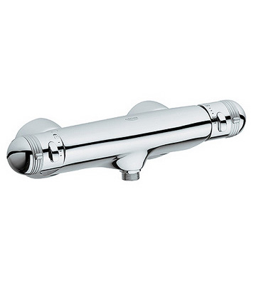

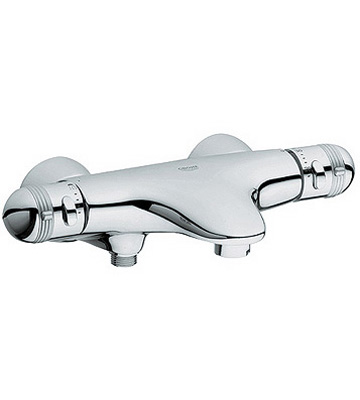

    The wet wall (where the shower head and valves are) in my shower backed up against a pocket door, and access would not be easy if maintenance was required at the back. I chose to use an external mount control valve. I think I heard they stopped making this model, or at least stopped importing it into the USA. They made a shower only version as well.
