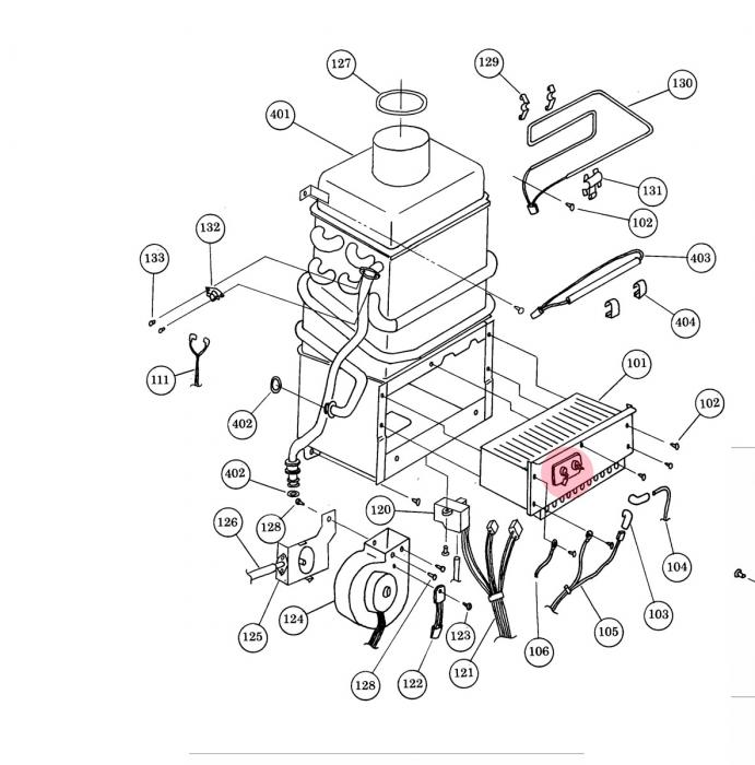

    All of the sudden, there is no hot water coming into the bathtub. The error code flashing is 12. I believe that is for a fuel sensor? Is that something common to go bad? Expensive? We can't find a dealer near that does repairs, so it is something we can order and install DIY? While researching this topic, I read that hard water isn't good for our tankless. Our softner quit about a year ago and we didn't replace it. Could that have anything to do with the error? (we have a sand-point shallow well)
    The kitchen sink water did get fairly warm today. It has always had low water pressure compared to the bathtub. The heater didn't "blink" error code with that, but does when we run the tub. Any thoughts?

    Error code 12 is a flame sensor error. Buffing it clean with a fiber-tex or similar (soft-pot-scrubbers, not steel wool, not sandpaper) usually does the trick. It's an annual maintenance thing for some installations, goes for years in others. Some modulating-condensing boiler flame sensors have similar issues.
    If you don't already have it, download the manual:
    http://www.takagi.com/download/produ...uals/T-KJr.pdf
    You can figure out how to find the flame sensor from the exploded diagram on P.24. (Be sure to turn off the power and the gas before opening the sucker up, eh? ) While you have shut down and open, clean the filter too (an annual maintenance thing in most installations.) Walk yourself through as much of the maintenance protocol on p.16 as you're competent to do before buttoning it all back up.
    thank you so much!! Sounds way cheaper! LOL
    still no hot water after we cleaned out the filter. I couldn't find the location of the flame sensor. The flame sensor wires we found, but not the sensor. Any clues? It's not listed on our manual.

    Quote Originally Posted by aksmieja View Post
    Its held onto the front of the burn chamber by a couple of screws. I see if I can find a diagram fro you.

    Here is the diagrahm. The part in the red circle.

    I guess things got a little off track from my post. LOL
    Anyway, NO I would never blame the installer because that would be me, my husband and a guy we hired to remodel our bathroom. A secondly, I wouldn't expect a refund or any warranty work because it's 5 yrs old! All I wanted was to find out the problem, order a part and get hot water back for my shower.
    To update... my husband ended up calling Takagi and I was so impressed with the service tech. He spent over 2 hours on the phone walking us through everything. And honestly, he probably saved our home from burning down and inevitably saved our lives. There was some kind of switch that was in the wrong position, so it failed to "shut off" sooner because of the soot build-up.
    The filter only had a little sand in it and from what it looked like, our water must not be as hard as we thought (although we will look into getting another water softener). It's the exhaust pipe that literally turned my husband and the near vacinity black. I had quite a mess to clean up when he was done, but now we know what to do as far as maintenance. Like I said, that tech gave us the best customer service I've ever experienced. If I had his name, I'd make sure to send him a letter of thanks. All customer service should be 1/2 that great.
