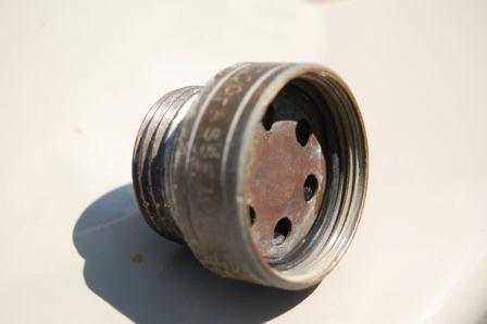

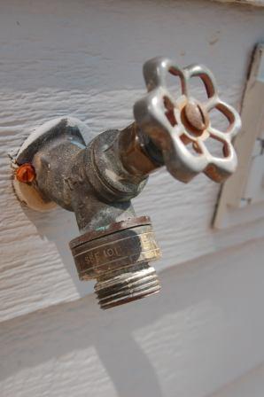

    I have an outside faucet that has a vacuum breaker on it. The vacuum breaker has faulted and needs to be replaced. The threads that attach to the faucet are not standard. They look to be 1 inch and finer then pipe threads. I have been to every plumbing supply store in the area without success. The only marking on the faucet is "T-J". The breaker has "TANNER MFG. ERIE PA. N0. 928000 - ASSE 1011". The house was built in 1988 in Minnesota. Any idea how I can get a replacement for this? Tanner Mfg. doesn't seem to exist.
    Any help would be appreciated.
    Thanks

    Go to any plumbing supply house and ask for a Watts 8A vacuum breaker, you may be able to find it at the big box stores also. Don't worry about the brand, all breakers of that type will work, luck.

    As I mentioned, I've been to a number of places including big box stores before going to a couple of large plumbing supply houses. They did not have anything that would fit. Of course they had Watts 8A vacuum breakers. But, the Watts 8A vacuum breaker's inlet connection is a 3⁄4" (20mm) standard female hose thread. What I am looking for is at least 1" and the threads are not standard.

    The fine thread is the kicker here....code requires if you remove the vacuum breaker you can't hook a hose to it.
    Since Tanner is gone, you can try to see if someone else's fine thead vacuum breaker kit might fit...no guarantees. Prier has a C-434KT-806, Arrowhead has one, maybe Woodford.
    If not, time to replace.
    Any chance you can just remove the insides and now it becomes an adapter after which you just attach the Watts 8A???
    Quote Originally Posted by wraujr View Post
    That's a good idea. However wouldn't the original vacuum breaker have to be modified to plug the holes that still exit? I was thinking that maybe I would have to solder or weld a metal ring inside to cover the overflow holes?

    It is proprietary to the manufacturer, so if they are out of business, then YOU are out of luck, unless it was made for them by a company which is still in business, AND is still using the same pattern, which seldom happens. Replace the faucet, there is NO other way to fix it.
    Smile Got lucky
    After going to every big box store and two big plumbing supply stores (Graingers and Ferguson) and them not having any thing that would fit, I stopped by a little local plumbing supply shop. They had one from Nibco that worked. It sure beats breaking through a wall to replace a faucet.
