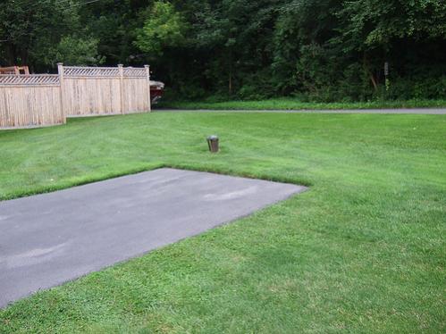

    I am gonna post some pictures tonight of the area I am looking to plant the tree.....that way we all can see the area we are talking about...
    see if that affects anyones opinion...

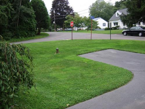

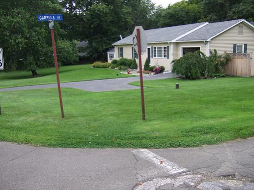

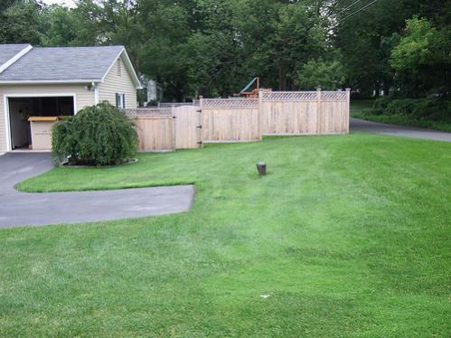

    Default Pictures of area of planned tree
    Here are pictures of the area of where we want to plant the tree.
    As you can see we are on a corner lot. The corner is quite a busy street corner.....so we were hoping an evergreen tree would provide a some screening and shade.
    Like I said above our initial thought would be to plant the tree somewhere between the street signs and well cap....
    The distance from the well cap to the middle street sign is about 25 feet.
    thanks.
    mm
    6,361
    Plant a hedge just inside the property line/road right of way. Paint the casing and cap green to match the color of the grass now and you'll hardly see it.
    Don't take this the wrong way, but I think your wife has got too much time on her hands, You can barely see that. I wouldn't bother doing anything. It is what it is. Here's a suggestion: buy a wooden whiskey barrel cut out the bottom, sit it ontop of the cap, and fill the inside of it with natural looking fake flowers. Or buy an old wheel barrel, angle it over it, and fill the wheel barrel with real flowers. If you don't have kids, get one, and that will take up all her time, and she wouldn't then care if that well cap grew.
    You could also, sit a birdbath on top of it. My birdbath has a wide opening in its base. Let me know what she thinks of my suggestions.

    Funny stuff, cookie......
    I agree.....you can hardly see it. To be honest with you though, she wants the garden bed/tree in that open space between the cap and street signs for aesthetic purposes too, not to just camoflague the well cap. Plus, the tree when it matures will provide some screening and shade to the front of our house.
