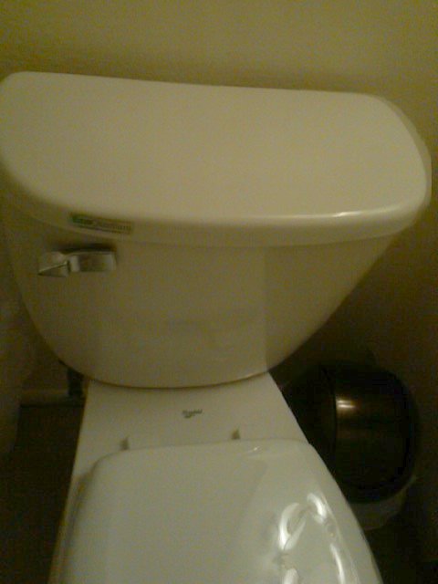

    Hi terry - I have a simple and hopefully not silly question -
    I have the horrible ecoflush unit mounted in a mansfield toilet unit. It is a 3 bolt attach tank.
    is it possible to simply remove it and replace it with a simple flapper style flush valve and be done with it? Or is the entire toilet specialized to the ecoflush?
    image of my toilet and example flush valve kit included
    Thanks in advanceName:  IMG00290-20130425-0847.jpg
Size:  30.9 KBName:  15543218.jpg
  6. #51
    12,427
    The bowl is specially designed for a pressure assist tank. Changing to a flapper won't help.

    You can't put in a flapper, but you can, at some expense, put in a Sloan Flushmate that is designed specifically to replace the WDI Ecoflush.
    For the Mansfield Tank 119, I believe the model number of the replacement Flushmate is going to be M-101526-F3HMK. It is, however, going to be north of $100.
