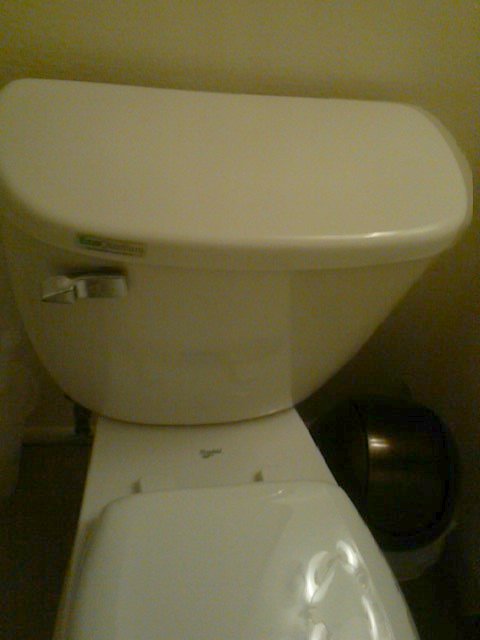

    Hi terry - I have a simple and hopefully not silly question -
    I have the horrible ecoflush unit mounted in a mansfield toilet unit. It is a 3 bolt attach tank.
    is it possible to simply remove it and replace it with a simple flapper style flush valve and be done with it? Or is the entire toilet specialized to the ecoflush?

    The bowl is specially designed for a pressure assist tank. Changing to a flapper won't help.

    You can't put in a flapper, but you can, at some expense, put in a Sloan Flushmate that is designed specifically to replace the WDI Ecoflush.
    For the Mansfield Tank 119, I believe the model number of the replacement Flushmate is going to be M-101526-F3HMK. It is, however, going to be north of $100.
