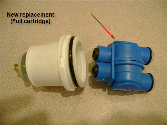

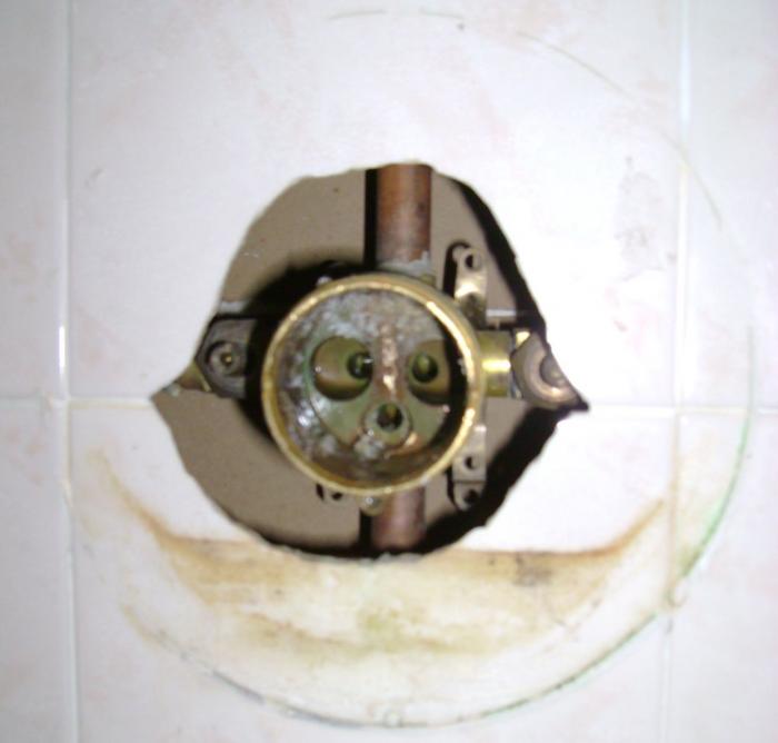

    I am trying to replace an old Delta Monitor Valve (1300/1400).
    I was able to remove the cap assembly rp19806, showing the old house assembly (rp19805).
    How do I remove the old housing assembly rp19805 from its place?
    I tryied pulling it with "reasonable" force but I am afraid it may break or something else may give.
    Thanks in advance for your help.
    mal.

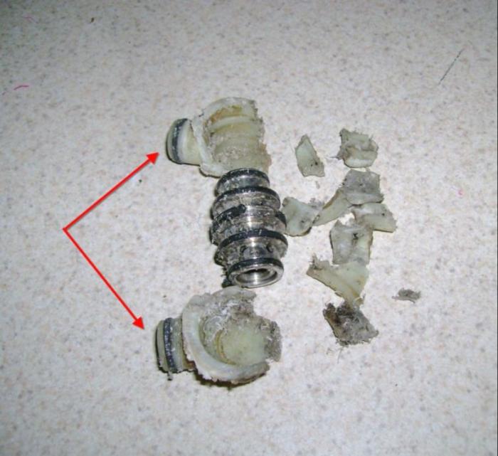

    Enclosed are a couple of pictures...

    Had to use my Rotor Zip and break it in pieces. No way I could pull it without damaging the rest of the piping. Even tried to use heat with a torche. It didn't move. So, I decided to cut the plastic, remove the metal inside, and then use a set of needle nose pliers to rotate and pull each of the two inserts.
    Indeed as you mention, it was the Oring that was stck to the pipe.
    Cleaned all up, fine sanded any deposits left from the old Orings, placed the new cartridge, and all is back to normal. What a job!.

    WOW....never saw one gunked up quite that bad. You need to clean out the body really well so the new orings will seal. Vinegar is good, but you could use something stonger like CLR. Don't get that on the new rubber or plastic parts.
    Dec 2007
    7,460
    I think a lot of that is plastic from using the roto-zip...
    I hope you didn't damage any of the sealing surfaces...
