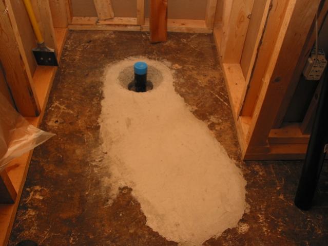

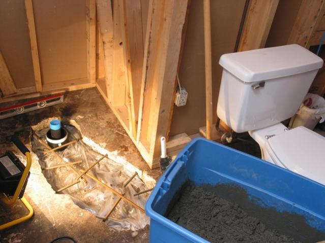

    I've made a few strides since I last posted. Before I filled the hole with the sand and gravel I drilled nine 1/2 inch diameter holes, 3 inches deep into the sides of the concrete for the rebar. This can be difficult. The hammer drill went throught the concrete with relative ease but when it hit a rock it slowed dramatically. Very slow going through the rocks, and there were many. After a while I started inserting a punch in the hole and whacking it with my hand sledge. I think this cracked the rocks because I was able to proceed again, at least till I hit another rock. Anyway, it took several hours just to drill 9 holes......

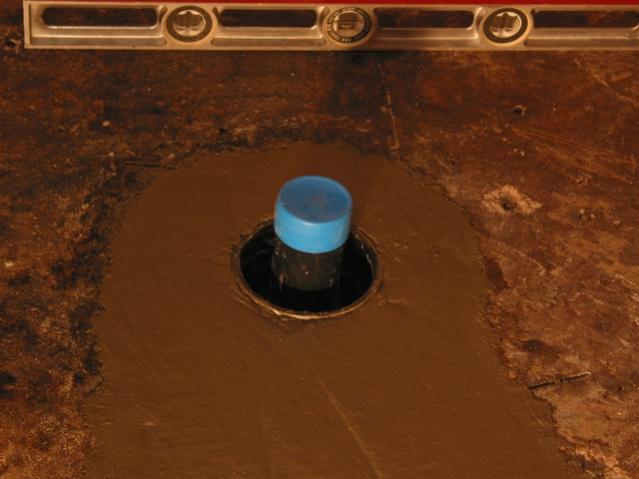

    Once done I cut the rebars with my little 5 inch grinder and then inserted them in the holes. I then placed the vapour barrier and also put a 4 inch piece of ABS around the drain. This is a trick I learned from CX on the John Bridge site. I'm doing a Kerdi Drain so one needs to leave room for the drain to get below the concrete. About an hour after I poured the concrete I carved into the concrete with a brick laying trowel just around the drain while the ABS was still in embedded. (See pics) I then pulled the ABS out. I know the Kerdi Drain will fit nicely in the whole and when I build my dry pack mortar bed I'll fill in under the drain.
    Once all this was done I covered the wet concrete with some poly to keep the moisture in. Best not to rush the drying so you avoid cracks. The poly was on for about 5 days. I also used a crack resitant concrete that had fibres mixed in. For the amount of concrete I used the price was meaningless.
    I mixed all the cement in a 35 litre plastic storage bin. Not the greatest but it fit in the bathroom and it did work. Mixing was hard work but who said this was going to be easy? I cleaned it out in my backyard and I could use for storage because I cleaned it before the cement dried. Cement is interesting. I so wanted to add more water while mixing (I didn't) because it seemed so dry. However, once in the hole it magically had enough water.......

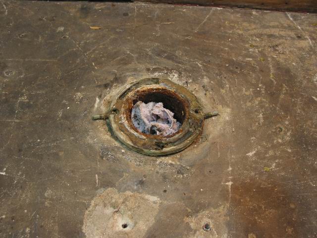

    I'm currently drywalling my bathroom but I'm planning forward for installing the toilet. I'm going to be pouring some self levelling cement at some point and the toilet pipe and flange will be affected. So, I have a few questions;
    1. How do I remove the flange (see picture). Is it just friction fitted to the pipe? Can I just pry it up? The pipe is cast.
    2. What is the best method to extend the pipe just a half inch or so to gain the height that the self levelling cement will create? Should I just use one of those flange extensions. (see 2nd picture)
