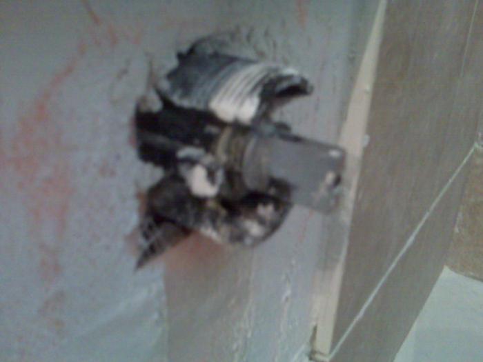

    Hello,
    I was hoping someone might be able to identify this faucet. I am looking to replace the handle so if anyone could point me in the right direction I would really appreciate it. I have purchased and looked at newer handles but could not find one that will match up.
    Thanks

    My first guess is that it is a badly abused Price Pfister Avanti faucet.

    I looked through the Price Pfister website but could not locate any valve that looked similar. Any thoughts on where I could pick up a single shower handle that would work with this valve.
    My next thought is to attempt to remove the valve and see if any local stores can identify it &/or suggest a handle.

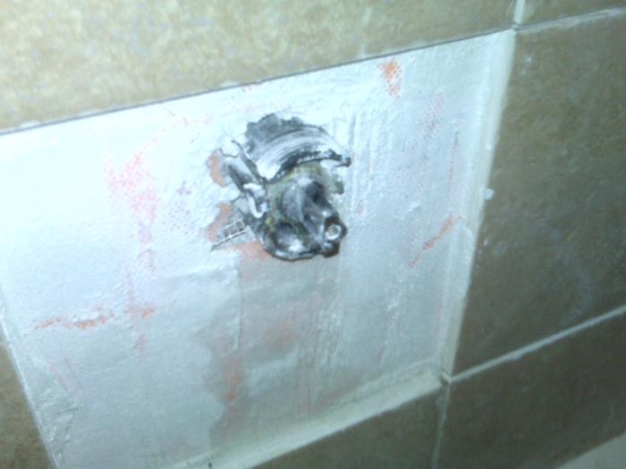

    It looks like you are redoing the tilework. It really behooves you to replace that valve with a new one. Finding a new handle and trim sometimes costs nearly as much as a total new valve. A new one should be more reliable, and have parts available.

    I will take a look at it this evening and see if I can somewhat easily remove the valve for replacement.

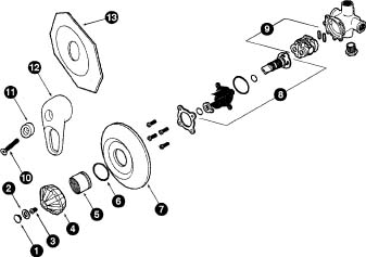

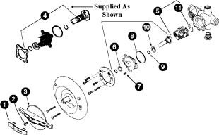

    I was able to confirm that it is a Price Pfister stem. Then guy at Ace was able to find it in their product (Danco) book. Looking online I found the site below which give a diagram of the set up.
    http://www.candlsupply.com/products/...%20pfister.htm
    Unless I am missing something it looks like there are 3 handles that can work with this valve.
    1. PP974-510 Handle - Rectangle looking handle
    2. PP940-145A Loop Handle - downward handle like what was on there
    3. PP940-240 Handle - Knob handle
    By chance does anyone know if these handles or the corresponding face plates come in Brushed Nickle... My girl wants everything to match; I'm more concerned with running water at this point.

    The octagonal faceplate, if it you can even find one, will be chrome or polished brass. Fortunately, your tile is not cut to fit the octagonal plate so the round one will work for you. It is available in all the modern finishes, but, you may need a "retainer adapter" to secure the plate, depending on the age of your valve.
