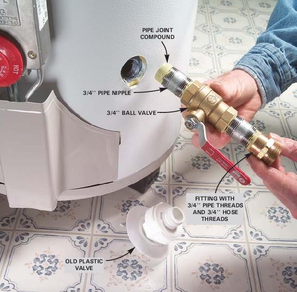

  • You will need to turn off the gas/ electricity to the water heater along with the water supply.
  • Drain the tank all the way down, and then carefully remove the drain cock.
  • I normally install a 3" long ¾" nipple in its place with a full port threaded ball valve to help add in this process.
  • Now that the ball valve is in place I take a stiff wire, like a coat hanger and poke and scrape along the bottom of the tank to break up the sediment.
  • Then I turn the water supply on to the tank to help flush the sediment that I loosened up out of the tank.
  • Rinse and repeat till you no longer get anything coming out anymore.
  • Remove ball valve and nipple and reinstall drain cock. If old drain cock is plastic then leave the ball valve.
bradc2009
Thanks for the quick response. Is the drain cock the spigot that I attach the hose to for draining the tank?
And what is a ball valve?

Yes the drain cock is the part you hook up the garden hose. Here is a picture, they claim it is worth a 1000 words.
